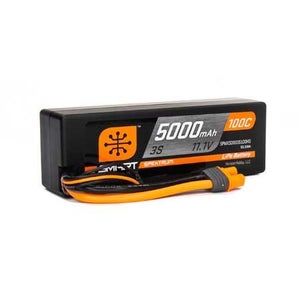

- I recommend Spektrum smart batteries for lipo batteries because they provide more flight time.
