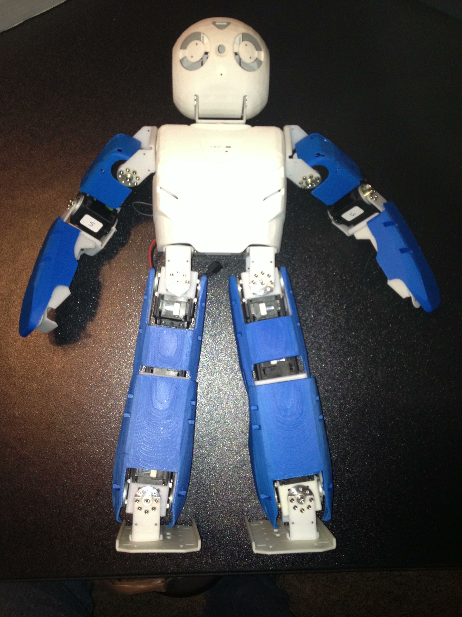

Introduction: 3D Printed Humanoid Robot for Under 1000.00 USD
This idea was born from my first 3D printed Humanoid robot project. My 3D printed DARwIn-OP clone. I learned a lot when doing this project and I am still working on making this robot better. My project had one major flaw though. At 6000.00 to 7000.00 USD per robot few people could duplicate my project. After thinking about this problem and seeing the work being done on Jimmy the 21st century robot and the Robosavvy Humanoid Robot design contest. I decided to start this project. I also decided to break it down in steps to make it easier on myself.Step one: use as much off the shelf parts as I could to get the robot up and working.Step two: Find ways to improve the robot and make it cheaper.Step three: Experiment with and open source the project to see if other people could duplicate the project. As this was one of the major goals of the project. To make humanoid robots cheaper and more accessible to the public.
Step 1: Parts List and Where to Buy
Robot cost break down:
AX-12A servos (18x37.42 = 673.56)
CM-904a servo controller (1 x 15.00 = 15.00)
Raspberry Pi, high level brain (1 x 40.00 = 40.00)
Raspberry Pi camera, for vision (1 x 30.00 = 30.00)
11.1 volt battery (1 x 29.90 = 29.90)
Bioloid Bushing set (1 x 4.99 = 4.99)
Bioloid Bolt and Nut set (1 x 23.40 = 23.40)
3 pin Bioloid servo cable pack(1 x 34.90=34.90)
2.2 ibs spool of abs plastic (2 x 31.99 = 63.98)
Servo bracket STLs free download.
Control software free download.
Total for robot (915.73 USD)

I use the UP! Plus 3d printer version 1.2 but you can use your favorite 3d printer or 3d printing service.
Step 3: Parts Files and Creating .STL Files
You can download most of the part files from the Robotis and Trossen websites or you can downloaded them from my Thingiverse page. I use AutoDesk Inventor to create my .STL files.
Thingiverse link
Bioloid link
Trossen link.

Add the Raspberry Pi and Pi camera to make the robot smarter.
Add sensors like IR and sonic for obstacle avoidance.
Zigbee for remote control.
Step 8: Make It Cheaper
Use the OpenCM controller instead of the CM-530. That will save almost 100.00 USD.
