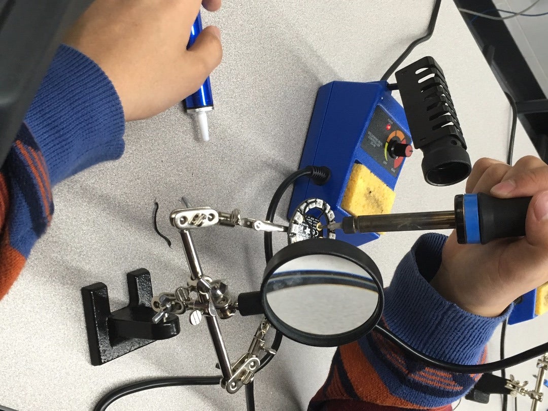

Step 7: Making Your AT-AT Walk
For the following step, you will need the following pieces:
  1. Motor Gear
  2. Micro Gear Motor
  3. SPDT Slide Switch
  4. 9V Snap Connecter
This part is quite simple if you are experienced with soldering. All you have to do is simply solder the 9V Snap Connector to the the SPDT Slide Switch, and then solder more wires onto the remains of your Snap Connector. Proceed to solder these wires to your Motor. Your motor will go in the small compartment that is on the left frame. The motor gear will be attached to the other side of your motor, and will rotate the other gears. The other side of your 9V Snap Connector will be attached to 9V Battery. Congratulations! Tuck your wires into the exterior and connect to the interior. Your AT-AT should be able to successfully walk!
