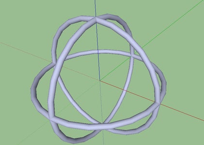

Step 6: Follow Me Tool
i put this one in because I've noticed it frustrates people, all you need is a face (profile) and a line (path) hover over the profile and it will turn dotted like when using the "push pull" tool, pull the face and put your cursor on the line, it should turn red and you can follow it to the end, use the eraser to soften the line and your done
