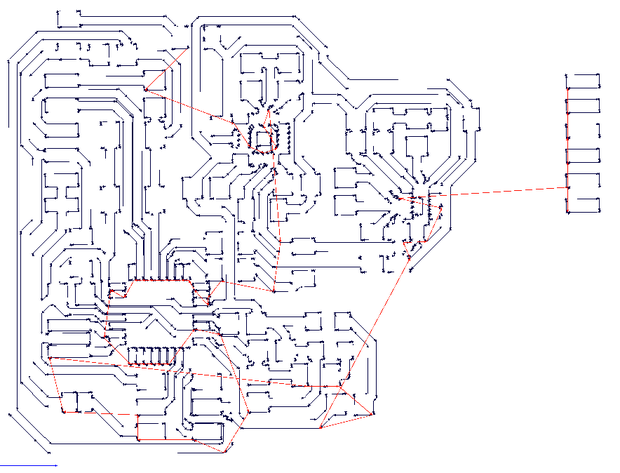

Step 4: Schematics and Board Layout in Eagle
I reworked the schematics provided from Sparkfun for their board to use the new accelerometer/magnetometer chip and changed all the resistor/capacitor sizes to more human-friendly 1206 packages. I used a few 0Ohm resistor jumpers to route the circuit in one layer. All my eagle files are included in the github repository.
You can see that there is an extra set of pin connections on the right side of the board that is not connected to the rest of the circuit. I added this to more easily mount my board on my particular project. You could omit these if you want.
Step 5: Mill PCB
I exported the board layout top layer from eagle as a black and white png at 2400 dpi. I created an image of the very small details on the board, so that I could do an extra pass of just these areas with a tiny end mill. I also created an outline layer that will allow me to cut out the border of the board and drill holes for the through hole connections. You could choose to omit those holes if you wanted to use surface mount headers. I've attached all the pngs and the photoshop document above (most recent stuff is on github).
To create my tool paths, I ran the files through the online fab modules with input format png, output format Roland MDX-20, and process mill PCB traces. I wanted to clear all the unwanted copper from my board and I had a lot of surface to cover so I put a 1/32" end mill in the Roland and changed the diameter of the tool to 0.79mm. I also set the number of offsets to -1 to completely fill the board with paths. The resulting path looked like this:
I saved the file as 9Dof32RoughCut.rml (attached).
Next I went in with a 1/64" end mill and milled out more details. This time I set the tool diameter to 0.39mm and the number of offsets to 1. Here is the resulting path:
I saved the file as 9Dof64FinishCut.rml (attached).
Next I used a 10mil end mill to get the last bit of detail This time uploaded the details.png to the fab modules, set diameter to 0.25mm and num offsets to 1, and set the speed to 2mm/s. Here is the path:
I saved this as 9DofFinish10milPass.rml (attached).
Finally I cut out the board and drilled holes for the FTDI header pins using a 1/32" end mill. I loaded the outline.png file into the fab modules and selected PCB outline under process. Here is what the path looks like:
and the Modela file is called 9Dof32Outline.rml (attached).
My finished board is shown above, it turned out great. There were some minor issues of course: there was one short circuit left over after milling that I had to remove with a razor blade, and a few of the orphaned leads to my Gyro chip popped off during milling - this shouldn't be too much of an issue. I also accidentally dug into one of my traces because I started a finishing path with the wrong x/y offset - be sure to double check these each time you run the Modela. (see images above)
