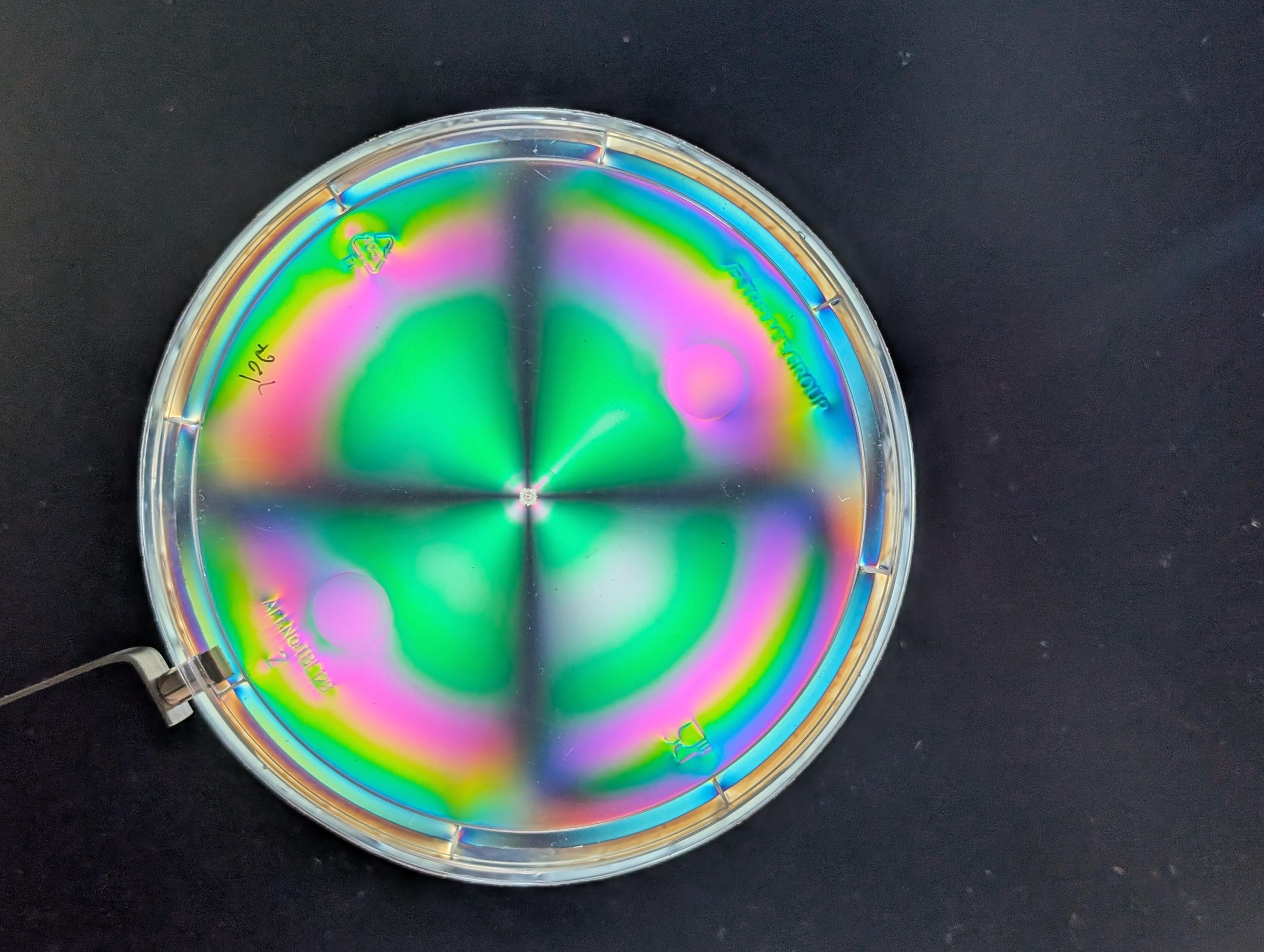

Now apply power to the LED. Looking directly down on the LED the light should be well extinguished, at skew angles less so. However, without the diffuser you will only be able to see light that has gone through the polarizers at one angle. So, place the diffuser on top of the polarizers. You should now see the symmetric cross pattern of transmitted light. In directions aligned with the easy and hard axes of the polarizers the extinction is good. In all other directions there is light leakage. Using a white LED you may even be able to discern a blue tinge at the very center. Extinction performance of these polarizers is optimum for red light but drops off for blue wavelengths.
Step 5: What Do You See?
This is the kind of pattern seen looking down on the diffuser sheet.
