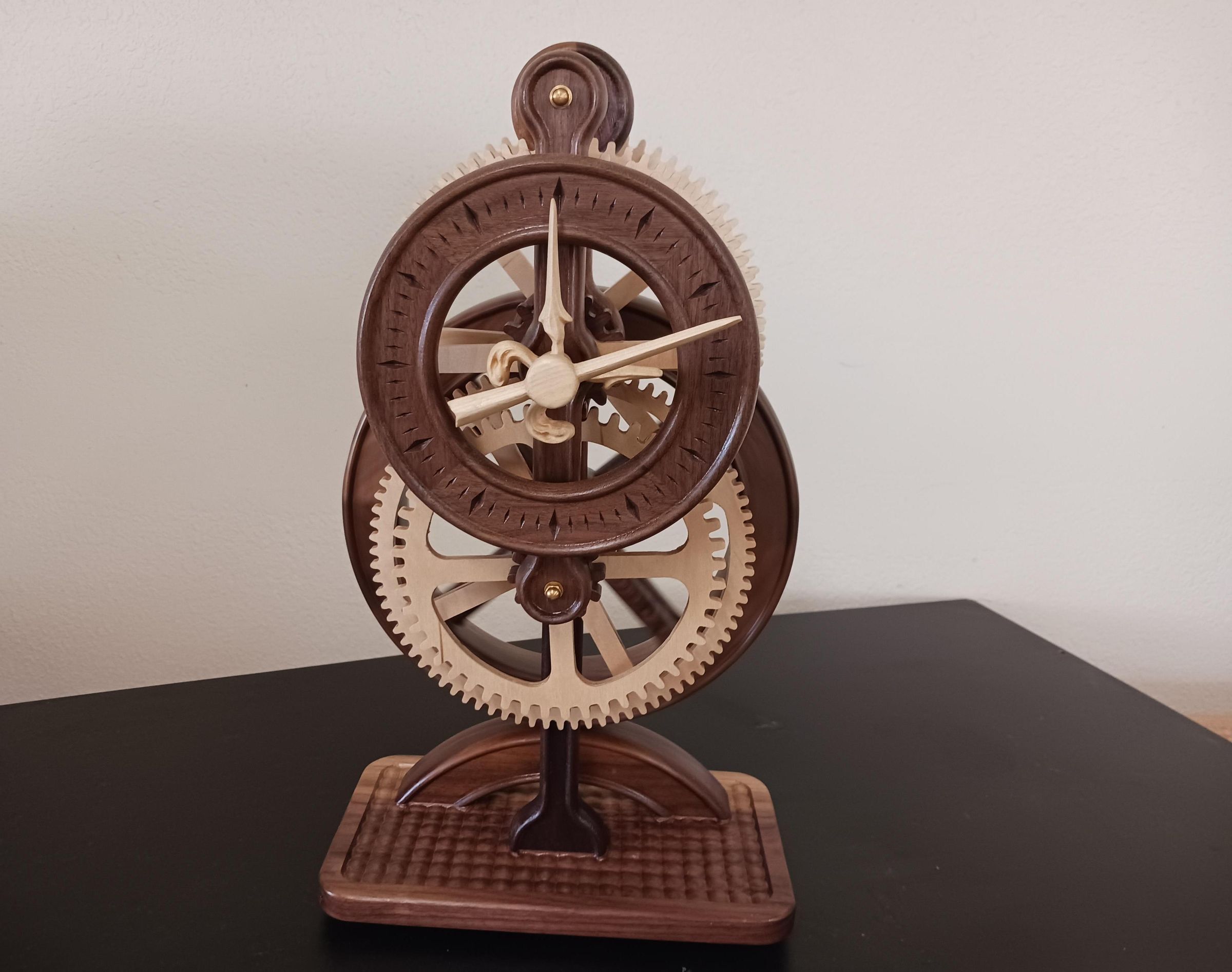

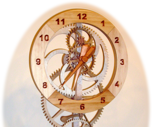

Synchronicity is a unique exposed wood gear pendulum wall clock, with a combination of old and new tech.
Many wood gear clocks are driven by weights. These clocks need to be wound periodically, as often as every day. I wanted to build a wood gear clock that did not require that frequent winding.
Some designers use an electromagnetic pendulum to drive their clocks. The pendulum contains a rare earth magnet which passes by a coil or two. As the magnet passes the coil, it induces a current in the coil. This triggers electronics to put a pulse of current into the coil (or a second coil) and repel the magnet, giving the pendulum a push and powering the clock. I chose this method to power my clock.
Often times wood clocks of this type are not very accurate. Wood expands and contracts with changes in temperature and humidity. I wanted my clock to be accurate, so I use a microcontroller in my electromagnetic pendulum drive so that the clock keeps perfect time. My circuit is powered by 4 D cells, which will operate the clock for up to three months.
