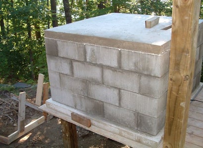

For a simple structure for the vermiculite base to sit on i suggest using cinder blocks, they are cheap easy and fast to install... i recommend making a minimum 70-100mm concrete slab for the base to sit on if using this method, the vermiculite base is not designed to be structural.
Picture attached of an example of what you may choose.

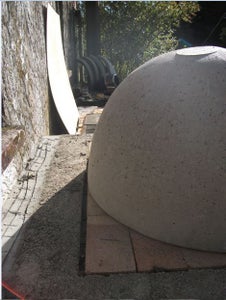

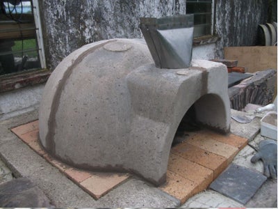

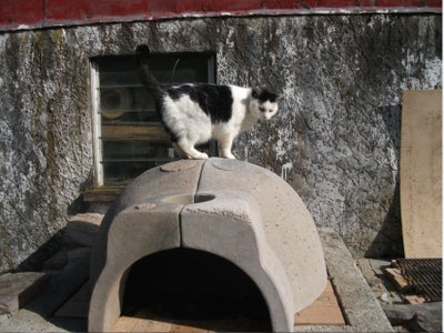

Step 2: Erecting the Dome.
Now its time to erect the dome.
Start with the rear corners, put one in place... it should just stand by its self but wedge a piece of wood or something on the inside so it cant fall over.
Then lean the 2nd piece against it.
You can use the lines of the fire bricks to get the center and get it even on the fire brick surface as seen in pictures.
Remove the piece of wood, they will stand up fine by them selves.
Its probably after 12pm by now, it would be a good idea to crack a beer at this stage.
Then move onto your front pieces, put the first one in place and hold it up with that stick and then put the 2nd one up.
Now remove the stick.
If they are not lining up that well you may need to pack a couple of pieces up as bricks are often not a perfect flat surface.
Just use a trowel or something and lift the bits that you need to and slip in bit of stone to hold them in place.
you can see the packers i have used if you look closely in my pics.
Remember, you are focusing on getting the internals lined up, not the externals.
Once you are happy with how they are sitting its time to move onto the next step.

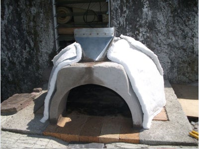

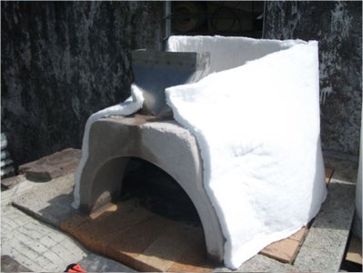

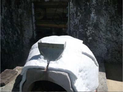

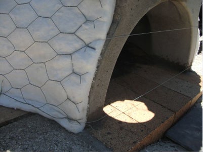

Step 4: Crematic Blanket Insulation.
First off, safety.
This stuff is not good on the lungs or on the skin... is a lot like old pink bats.
I suggest gloves, full sleeve top, pants and a dust mask.
Basically follow pics for how i have installed.
3.5mtrs is provided.
Wrap it around long ways... that's 2.5mtrs length, cut it vertically when in place until you reach the curve of the dome, do this at each dome join and fold them over.
Cut a hole in the left over piece for the flue and throw it over the top.
Feel free to do this differently if you like, just maker sure you try to overlap any cuts you make... this will keep the high temp heat in and not allow your render coat to become a heat sink.

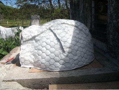

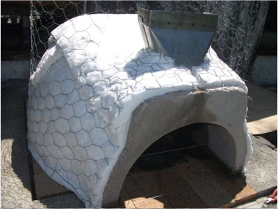

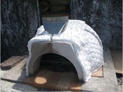

Step 5: Chicken Wire Reinforcing Mesh.
This is put on in much the same way as the blanket.
Your kit would have been lashed down with small wire, use this to pull the chicken wire tight in front of the main entrance.
The wire i use is the larger hole mesh, i can provide smaller hole mesh on request... i find the larger hole stuff much better to work with and makes curves better so this is what i provide.
Pull it all nice and tight so that it holds the blanket nice and snug.
If you have a different way of applying this wire layer go for it, this is what works best for me.

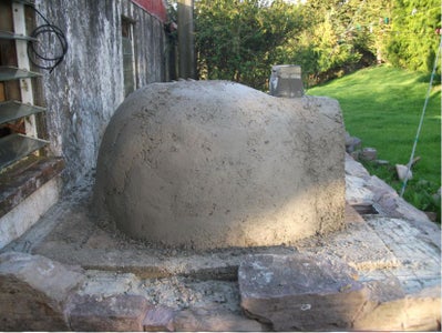

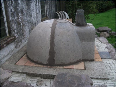

Step 6: Render (stucco)
This is where you can start doing your own thing, do some research on the net on render mixes or feel free to ask me some questions about mixes.
A lot of different people have different preferences of what to do at this stage.
I have provided with the kit enough 3mm sharp sand and cement to do a 4-1 (sand-cement) mix for your first layer.
I can also provide silica sand (from golden bay) and white cement if requested... this is ideal for a final layer if you want to add a coloured oxide
Here's what i have done.
As i made a ton of prototypes creating this dome, to make a oven with a great functional shape i had quite of lot of refractory domes for scraps.
I crushed up a couple and used them for my first layer of render.
This mix is 4.5 parts crushed refractory to 1 part cement.
When you apply the first coat push it in real good so it can wrap around the reinforcing mesh, once you have an even layer, if it is not quite rough like mine in the pictures give it a scratch so that the next layer has something to lock into.

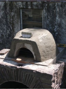

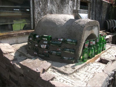

Step 7: Optional Secondary Insullation.
Here is a secondary way of insulating, this will help the oven hold heat for a long time.
I plan to do a lot of baking once the initial fire has been put out and ashes removed.
Use bottles just like bricks and build it up like in pictures, the air gaps in the bottles hold the heat.
I just used a standard mortar mix 5-1 for this.
Once the bottles were built up i just gave it a final render coat.
This oven will be square and voids filled with a mix of vermiculite and old concrete rubble from around the property.

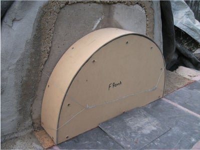

Step 8: Front Arch Form.
Provided in your kit is a sheet of 3mm mdf to build an arch for the front like in pic.
You may choose to make it a different shape depending on how you want your finished oven to look.
Here is an example of the one i have built for my oven.
Pretty self explanatory how to build it, just ask if you need some help.
Just remember to leave a recess for your door that you build to lean against, so build this arch form slightly bigger than the entrance opening.
The arch form i have built here also has a slight taper, the front of the form is about 4mm larger than the rear, this will make it easier to slip the door in.
You can use a lot different materials to make your arch, from wine bottles, bricks, stone to adobe and tile creations.... its up to you, let your imagination run wild : )

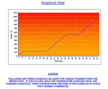

Step 9: Firing for the First Time.
Firing your oven for the first time is an extremely important step to follow closely.
Refractory cement unlike most other cements cure fully with firing.
If you have it on hand, a LPG gas burner ring is good to use for this as you can control the flame size, as most people will not have one i recommended making the smallest of fires and keeping it going all day.
It is best to use small bits of rotten wood, this will burn but will not create high temps.
You can control the fire if it starts to get too big by blocking the door and the flue starving the fire of oxygen, this will most likely be a smokey process but is worth it.
What can happen if your fire is to big at first firing is, the moisture still inside the dome pieces will turn to steam and start spitting pieces of refractory... also can make large cracks.
Here is the manufacturers guide, it is based on 250mm thick for a kiln, as this is nowhere near that thick you can 1/2 the times in this guide so try to keep it at 100-120 deg c for a day, then next day slowly bring the temps up fully watching for any sign of steaming.

Pressed Earth or Adobe
Standard bricks are primarily clay along with adobe bricks.
A major difference is that common bricks or firebricks are fired at very high temperatures, while adobe or pressed-earth blocks generally are not subject to to more than natural sunlight.
Theoretically speaking, you could construct a WFO entirely from handmade bricks of this nature. Even firebrick, the usual choice for the inner life of a WFO, is fired-clay brick.
The idea of using entirely local, on-site earth and simple human energy to make the bricks and build a WFO could excite many avid environmentally minded builders with enough time to devote to the project.
However it is vital to understand that there are, indeed, reasons why refractory firebricks and common bricks are the norm, and pressed-earth and adobe bricks are not.
At least one of those reasons is that firebricks are specifically and carefully designed to withstand the abuses of daily hot fires without deterioration for many, many years .
The same cannot be said for hand-pressed or sun-dried earth bricks, which will deteriorate relatively rapidly under the various forces at work in a WFO.
There is mechanical abuse (from loading wood), thermal shock (periods of significant cooling followed by rapid heating), and the abrasion and deteriorating effects of the exhausts of wood fires.
While it is grand to have visions of minimum environmental impact by using inexpensive, self-made bricks and mortar, you need to consider the immense time loss of building this way only to have to rebuild the structure in the not-so-distant future.
It is therefore more reasonable to consider using handmade bricks only for the external veneer.
Even here, though, you must be aware that adobe bricks are likely to have even lower thermal performance characteristics than common bricks, which are already low on the scale.
The fact that many pressed or hand-formed bricks contain plant fibers and such means that they have lower conductivity, lower mass, and correspondingly lower heat storage capacity, diffusivity, and so forth.
Although little actual data exists for adobe bricks' thermal performance, there close relationship to standard bricks means that they are not going to preform any better than the manufactured variety, and likely somewhat worse.
