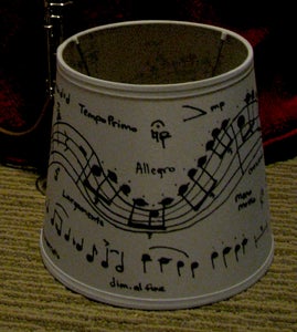

Step 4: Step 4: Decorate the Lampshade
I chose a white lampshade to allow the blue light bulb or other colors to shine through. I made freehand drawings of musical notations around the entire lampshade, starting with a curving staff. I used a black Sharpie Marker and it did bleed a bit. I believe any permanent type marker would work well.
