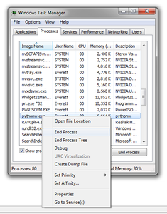

To shut down the prank they'll need to either unplug the board or end the python process!
