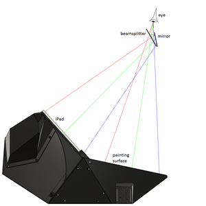

Step 1: How It Works
The first diagram shows how the components of the camera lucida are located relative to the Light Strokes hardware, seen from the side. Light rays from the iPad pass through the beamsplitter, are reflected from the mirror, and then from the beamsplitter into the eye. Light rays from the painting surface simply pass through the beamsplitter and directly into the eye, following the same paths as those from corresponding parts of the iPad display after their final reflection.
That's because the axis where the mirror and beamsplitter would meet is equidistant from both the iPad and painting surface. The angle between the beamsplitter and the mirror is 18°, which causes the twice-reflected image of the iPad's display to be rotated about that axis through 2 x 18° = 36°, where it lines up with the painting surface. The mirror and beamsplitter can also pivot together around that axis without affecting that alignment.

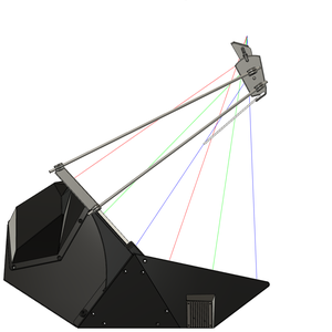

The second diagram shows the components that hold the camera lucida at that location. One can easily switch between looking at the virtual image of the iPad on the painting surface, and by slightly raising one's eyes, viewing the iPad directly, over the top of the camera lucida. The camera lucida can also be pivoted around its axis, to provide different viewing positions. In fact, it can be tilted completely out of the way, for an unobstructed view of the painting in progress, again without losing alignment when tilted back into its working position.

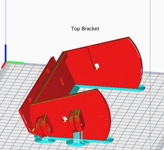

The 3D printed parts, attached here as STL files, can use PLA (as long as they won't be exposed to direct sunlight). Print at a resolution of 0.2 mm, with 15% infill. A heated glass bed coated with hair spray allows the parts to separate easily from the build plate when it cools.
The Cura screenshots show how to place the models for slicing with minimal supports. Be sure to remove any stray bits of PLA from the slots in each of the eight tube clamps that might otherwise prevent them from closing tightly. It can be tricky to remove all the support material from the slot for the first surface mirror in the mirror holder, but it can be pried out with a pick or small screwdriver, or cut out with a knife if necessary.
