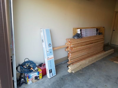

My workbench was designed to fit in a 14 inch deep recess in one of my garage bays. The length is roughly 10 feet.

Step 2: Unload Your Materials!
It is very important that you have a well organized system so you can work without having to stop and re-organize/search. I stacked my lumber of the same size together so I knew which pile to go to to grab from for the different parts of my system. This made it easy to keep my mind on task and produce my pieces quickly and without incident.
