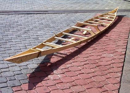

Now that the gunwales are done, the next step is to build the deck.
To build the deck we join the ends of the gunwales and spread them apart in the middle to establish the shape. Then we put deckbeams in between the gunwales so they hold the shape that we created. What we end up with will look sort of like a ladder that comes to a point at each end.

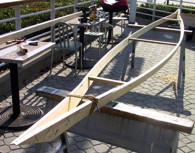

Step 5: Spread the Gunwales to Establish the Shape of the Deck
Do a wrap of rope in the front and one in the back of the gunwales. The rope should be about 36 inches long and tied into a loop. Turn the loop into 3 coils and slide it over the gunwale ends.
Step 6: Spread the Gunwales With the Center Spreader
Push the center spreader between the gunwales at the longitudinal center point of the gunwales. You won't have to measure since you already marked the center on the gunwales in a previous step. The top of the spreader should sit about half an inch under to top edge of the gunwales. Use two 4 penny nails at each end to nail the spreader into place. Leave 1/4 inch of nail sticking out since you will be pulling them later.
Put a windlass around the gunwales just to one side of the center spreader. This will help hold the spreader in place.

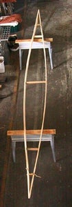

Step 7: Set Up Your Saw Horses

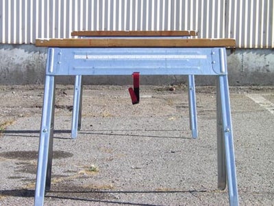

Set up your saw horses about 8 to 10 feet apart so the tops of both are in the same plane. You will be building your deck on top of the saw horses. If they are out of plane, your deck might end up warped.
This should really be step 2 but right now the reorder steps feature doesn't work.

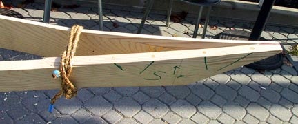

Step 9: Install the Bow and Stern Spreaders
Jam the bow spreader between the gunwales about 60 inches forward of center. Sart closer to the center and then push the spreader forward. 60 inches is an approximate number. The wider your boat is in the middle, the closer to center this spreader will end up.
You might have to adjust the position of the ropes at the bow and stern as well as their length to make the spreader fit.
Jam the stern spreader between the gunwales about 65 inches back of center. Start closer to the center and then push the spreader backward.
65 inches is an approximate number for the back spreader. Whatever the exact distance is, the back spreader should be about 5 inches farther back than the bow spreader. The idea is to make the back deck taper down more gradually than the front deck. The back deck should be fuller than the front deck.
Move the rope wraps at the ends in or out so the ends mate up more or less flush. You might have to adjust the size of the loop to get this to happen.
WARNING!
If the gunwale boards are of differernt stiffness, the stiffer board will want to stay straighter and its tip will want to slide forward of the other board's tip. Keep them lined up. Do not under any circumstances trim one of the boards to make the ends match up or you will end up with an asymmetrical deck.

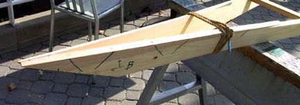

Step 10: Run a Saw Between the Gunwale Ends
At this point, you want to make sure that the ends of both gunwales line up at the bow and the stern and that both gunwales have the same amount of flare (incline inward from the vertical.)
When you have gotten the inside faces of the gunwales at the bow and stern as close to mating up as possible, run a saw between them two or three times. This will remove any high spots and improve seating. For very narrow or very wide boats, the ends may not mate up as well as for the median 21 inch wide boat. But don't worry, we will next dowel the ends together and that will hold them in place.

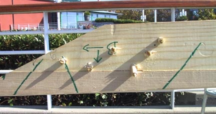

You are now almost ready to dowel the bow and stern together. But before you do, check the deck one more time. Make sure that the gunwale ends line up both at bow and stern so you don't end up locking them into an asymmetrical shape.

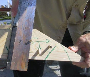

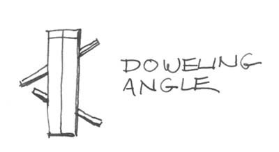

Peg the gunwale ends together using 5/16 inch dowels driven into 19/64 inch holes. Use 6 dowels for the bow and 5 for the stern. Do not put any dowels through the risers. As before, when you dowel, drill and drive one dowel at a time. Resist the temptation to drill all the holes at once.
Drill the first hole closest to the end straight through and make sure you don't get the ends out of alignment when you are drilling.
Drill all other doweling holes through the gunwales at an angle from the horizontal as shown in the photo below.

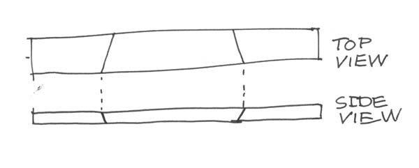

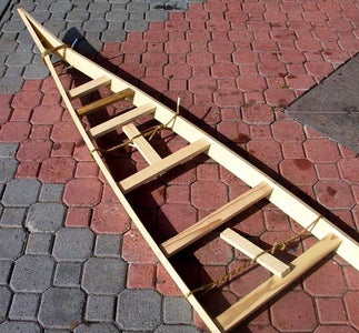

Step 13: Deck Beam Layout
There are 11 deck beams, six deck beams forward of the cockpit and 5 aft. Deck beam 1 is closest to the bow.
Deck beams 5 and 6 are curved. All others are straight.
You have already marked all the deck beam locations on the tops of the gunwales. All that remains is to cut the deck beams and install them at their proper locations.

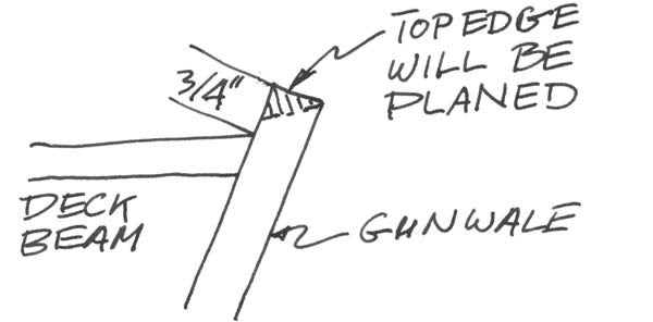

Keep in mind that the top of the deck beam should sit about 3/4 inches below the top edge o the gunwales. You can move the deck beam slightly forward or backward if it sits too high or too low. The only exception are deckbeams 4 and 7, the foot brace and back brace which must be located exactly where you marked them.
At this point you will see a gap between the bottom edge of the deck beam and the side of the gunwale. Later we will close up the gap before driving dowels.

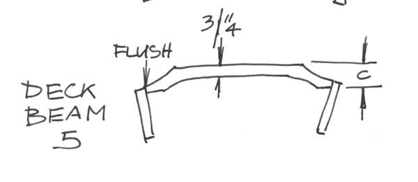

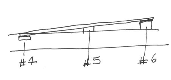

Step 18: Cut Deck Beam 5
Deck beam 5 is our other curved deck beam. To figure out how much elevation it needs, we lay a short piece of straight wood across deck beams 4 and 6 and measure how high the stick is above the tops of the gunwales at deck beam position 5.
If you have big feet and want extra toe room, lay the stick across deck beams 3 and 6. This will give you even more elevation. You will later add deck stringers to stretch from deck beams 4 to 6 or from 3 to 6 and this is what this stick simulates.

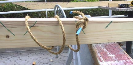

Step 19: Windlass the Gunwales

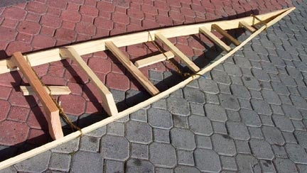

Once you have nailed all the deck beams in place, you are ready to give the gunwales their final shape. You will do this by applying windlasses and tightening each one in turn to increase the angle of the gunwales to match up with the ends of the deck beams.
Install the windlasses as shown using ü inch rope and a short stick. Take turns tightening each windlass a little bit to bring the bottom edges of the gunwales in.

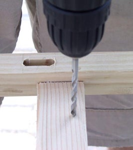

Step 20: Dowel the Deck Beams to the Gunwales

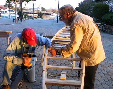

Now that the gunwales and deck beams are mating up flush, you are ready to dowel them firmly in place.
Each deck beam is currently held in place by 4 nails. Remove one nail, drill a 15/64 inch hole through the gunwale into the deck beam 2-1/4 inches deep and drive a quarter inch dowel into the hole until it bottoms out. Drill the holes so they come in at a slight angle in the horizontal plane. Then remove the next nail, drill and dowel and so on until you have replaced all 4 nails with dowels.
Step 21: Plane the Tops of the Gunwales
Plane the top edges of the gunwales from deck beam number 5 forward and from deck beam 7 backward. Plane them so they slope toward the inside of the boat at about a 5 degree angle. This way the skin of the boat will contact only the outside edge of the gunwales and not trap water between the skin and the wood to encourage rot.

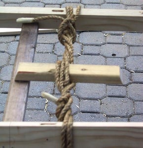

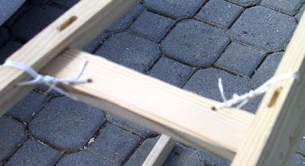

Step 22: Lash the Deck Beams to the Gunwales
The picture below shows one of the traditional Greenland lashing patterns.
Deck beams 2, 4, 6, 7, 9 and 11 are lashed to the gunwales. Opposite ends of each deck beam are lashed on opposite sides. Direction of lashing alternates from deck beam to deck beam.

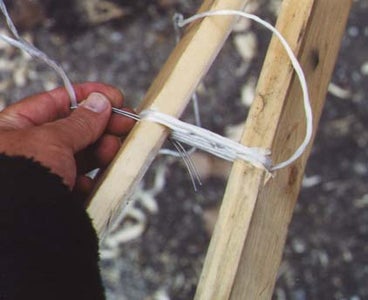

To do a lashing, drill a 3/16 inch hole in the deck beam and the gunwale. Picture where the lashing will cross the deck beam and carve a little notch there for the lashings to lie in. Likewise carve a notch from the lashing hole in the gunwale to the bottom edge of the gunwale. The notch in the gunwale prevents the lashings from making a lump under the skin.
To do the lashing, take about 3 feet of string and tie a loop in one end. Using a wire bent double as a needle slip the unlooped end of the string into the wire needle and thread the string through the bottom of the deck beam, around the top, around the outside of the gunwale, through the hole in the gunwale and then through the loop in the other end of your string. Tighten up the string and position the loop halfway between the deck beam and the gunwale.
Now do a few more loops, approximately 4 or so. Then tie a series of half hitches around both sides of the loop to tighten the whole assembly up. Melt off the end of the string.

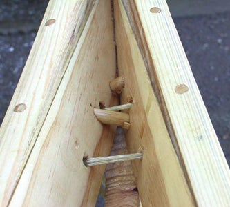

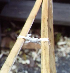

In this step you will add gunwale to gunwale lashings near the bow and the stern. These lashings will re-enforce the dowling work in the bow and the stern and keep the gunwales from pulling apart.
Turn the deck upside down. At both ends where the gunwales are separated by about 4 inches at the bottom, drill a 3/16 inch hole about 3/4inches up from the bottom edge of both of the gunwales. Notch the outside of the gunwales so the lashings will not show.
Run about half a dozen turns of lashing around the gunwales. Tie off in the middle with a series of half hitches.

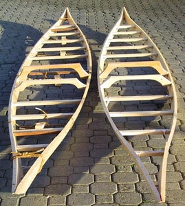

Step 24: Your Deck Is Done
Your deck is now done.
