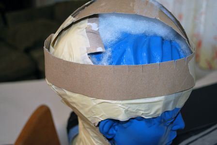

Step 4: Head Stuffing and Gap Filling
One easy way to make a flat area fuller is to stuff it. I had several bags of scrap batting left over from old projects, so I used some to fill up the top of the head. This made it taller, but the shape wasn't right. It looked more like a pillbox hat than a skull.
I pulled the stuffing back out and took the cardboard head off the mannequin. Using utility shears, I made a series of cuts on the bottom edge and put the head shape back on the mannequin. The cuts made the cardboard fit smoothly to the back of the head. I taped the cardboard in place on the sides and removed the tape holding the toilet paper roll on top.
I made another series of cuts where the former toilet paper roll and the back of head met. I taped them together and shoved loose batting into the gap between the mannequin and the cardboard. It looked better than before, but it still wasn't tall enough. I cut slits into the cardboard and tape at the very top of the head, shoved in yet more batting and re-taped. The profile looked great!
The back of the neck needed some filling out, so I cut pieces of cardboard to fill the gaps between the head and neck. I filled in the left side, then the right, and then taped everything in place.

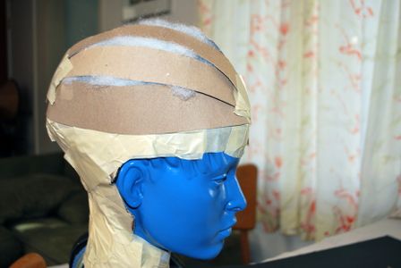

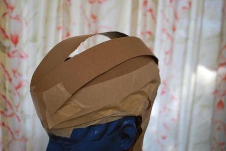

Step 5: Raising the Roof
Once the back of Kali's head was close to the right shape, I was ready to work on the top of her head. I figured out an approximate height and curve with my hand and then looked for some cardboard to use.The backing cardboard of an old sketch pad was just the thing. It was too wide, but that was easily solved by cutting it into 2" wide strips.
I taped one strip to the mannequin's forehead, made an arc over her head and taped the other side down to the back of her skull. I then added another strip around the side. Working from the left up to the top, I kept taping cardboard strips until I got an approximate head shape. I taped those strips together loosely, shoved loose batting to fill in the area from the side and took a look at the profile. It was a pretty good shape, but the strips of cardboard made the head look like segmented armor. Not precisely the effect I was after.
More snipping, clipping, and stuffing was required.

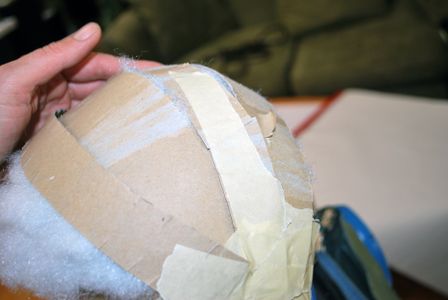

Step 6: Refining Head Shape
I peeled up the tape from the cardboard head strips and made a series of cuts on both sides of each strip. These would help me to mold the cardboard into a smooth head shape. After that, I used more strips to fill in the right side of her head, taping each cardboard strip into place and snipping each edge.
The strips were easy to move around, so I shoved loose batting in between them as evenly as I could. This filled in the top of the head nicely. One of the strips wasn't long enough, so I cut it, added an extension piece, and taped it down. I kept on stuffing until I got a good dome shape and adjusted the strips of cardboard so they covered the batting evenly.
After that, I taped the entire head as evenly as possible.

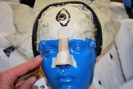

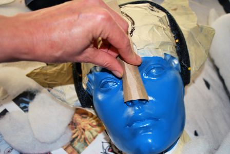

Step 10: Cheeks and Nose
Building up the face took some guesswork. I looked at the research to see the differences between my mannequin and the images of Kali. Most of the pictures had rounded cheeks, a prominent nose, and large eyes. Almost the exact opposite of my base!
I used my hand to get an idea of how much fullness to add to the cheeks. Next, I cut out cheek pads from a scrap of sheet batting leftover from quilting the Peacock Scooter's back feathers. I used a long, thin piece of the batting, wrapped it under the mannequin's chin and pulled it up on both sides to the ears. It looked good, so I set it aside and moved on to the nose.
I held a piece of toilet paper roll between the eyes and curved it out over the tip of the mannequin's nose. Once I got a shape I liked, I drew it on the cardboard, cut it out, and then taped it in place. Afterwards, I put the cheek padding back over the chin and cheeks and held it in place. It looked all right, but I wasn't sure if the nose was prominent enough. Not to worry. I could change it out later.

I pulled the batting towards the center of the face until its edges reached the new nose. It almost disappeared! For the time being, I moved on to the cheek and chin padding.
I adjusted the cheek pads and taped them down, and then pulled the strip of sheet batting from ear to ear around the chin. I taped over the padding as smoothly as possible, removed the tape holding down the nose base, and cut out another piece of batting to fit over the center of the face. That made the facial surface nice and even. I took the nose off and taped the center pad down.
Once the face was evenly padded I took the nose cardboard and traced around it onto another scrap of cardboard. I added about 1/4" to both sides of the nostril area and cut out a new nose, bent the sides down and test fitted it on the mannequin. It looked good, so I taped it in place. I left the bottom edge open, shoved loose batting into the nose with a pencil, and then cut a plug of foam rod to fill in the base. Nostrils could happen later.

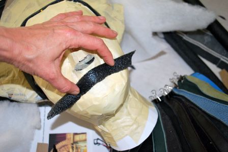

Step 12: Mouth, Tongue and Eyes
I cut a thin strip of ethafoam rod and trimmed it into upper and lower lip shapes. Next, I pinned the lips in place and started to carve a foam tongue. I cut out a general tongue shape with an exaggerated center line and test fit it. The curve wasn't right, so I checked my research again.
Kali usually has a fetching smile and her tongue sticks out past her lower lip. I wanted the tongue to form an arc over her lower lip and to come to a point right over her chin. To get that profile, I cut a couple of tiny wedges out from underneath the tongue and taped the edges together. Once the curve was set, I pinned the tongue in between her lips, drew in her eyes and eyelids, and outlined her nostrils with Sharpie.
So far, so good. Kali's face was shaping up!

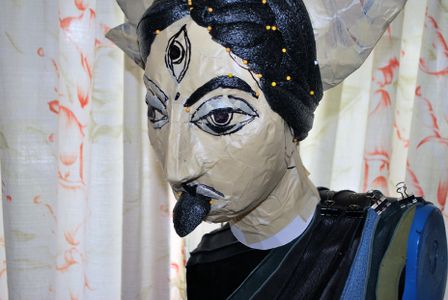

Step 14: Eyelids, Lip Lines and Final Check
Okay, I forgot to take pictures while building up her eyeballs and eyelids. Sorry about that. Hopefully, my description will give you a pretty good idea of the steps I took.
I found some glass terrarium rocksto use underneath the center of the eye. They were irregular domed oval shapes with flat backs and fit perfectly into the eye sockets. I taped those underneath the iris and pupil of each eye. I used some more foam rod to make eyelid shapes and taped those on, and then pinned the eyes in place. Much better!
I taped down the lips, outlined them with Sharpie, and cleaned up the edges with the point of a pencil.
Kali's face was ready to get draped.
