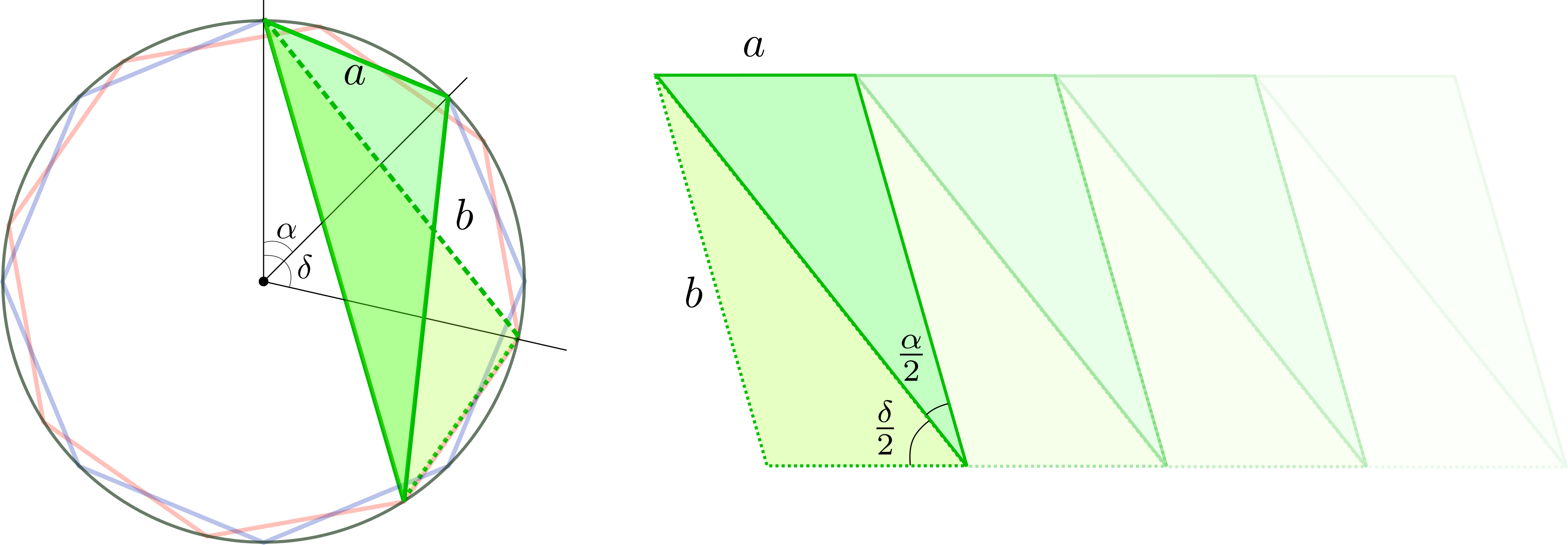

There two parameters that can be changed. The number of corners "N"and the angle of the parallelograms out of which the structure is built.
The origami deployable cylinder consists out of N parallelograms in a row with a fold in the long diagonal. You can't just use any parallelogram, there is a simple elegant relation between the polygon and the the parallelogram that makes it collapsable.
I used an octagon for this project so my explanation will use octagons, but it is applicable to whatever n-gon you desire.
Fig.2 - Schematic of two octagons with side length "a" rotated an angle δ with respect to ech other. On the right one can find the accompanying triangles with sides a and b, and angles 𝛼/2 and δ/ 2to construct the cylindrical triangulated origami.
This is schematically represented in Figure 1
On the left side you see a top-down view of a collapsed deployable octagonal structure. Being collapsed you know that every surface lies in the same plane so some simple geometry can be applied to find some relations.
In the collapsed form, the top red octagon is rotated an angle δ with respect to the bottom blue octagon.  The edges from the top octagon must be connected to those of the bottom octagon with a folded parallelogram.
Such a folded parallelogram is drawn in the octagons on the left, and drawn "unfolded" on the right.
A first observation you can make is that all the corners of the triangles lie on corners of the octagon. Therefore they all lie on a circle. This means that all edges of the triangle are chords of a circle.
Consider the green triangle first. In an octagon, an edge "a" will correspond to an angle 𝛼 in the center. With a being a chord, you can then use the "inscribed angle theorem" to find that the angle of opposite pointy corner of the triangle will be 𝛼 / 2.
One can see that the angle δ corresponds with the dashed line that connects a corner from the bottom octagon to the twisted top octagon. It is therefore also a chord, and again one can see that the opposite corner of the yellow triangle (with dashed lines) will have an angle of δ/2. It is maybe more difficult to see as this yellow triangle is partially obscured by the green one.
As you make some prototypes, this all becomes much clearer very fast.
The general rule of thumb is, if you have an N-gon, you can create a "deployable" origami structure out of parallelograms consisting out of two triangles 𝛼/2  (= 360/N/2) and the "twist" angle δ/2.

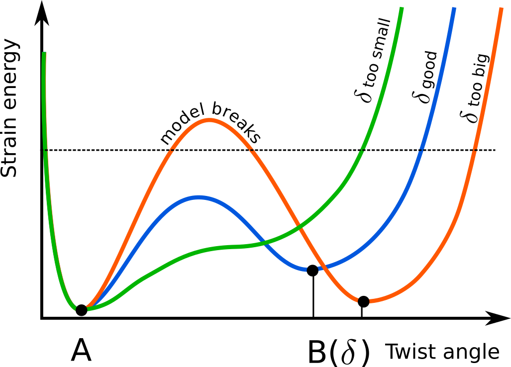

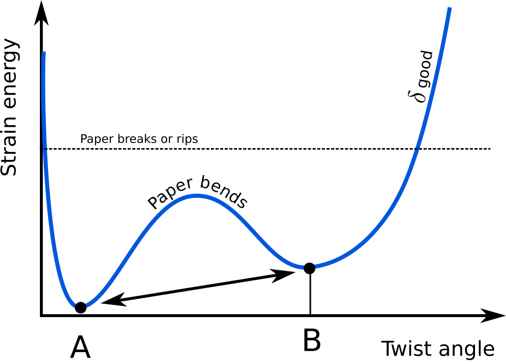

This angle δ is still an important design choice. The bistableness of the origami structure depends strongly on this angle δ, a good value depends a bit on what you want and what paper you use.
The bistableness comes from the fact that to open it, the paper is bent a bit, so some energy is needed to bend the paper in between the stable configurations, just like a light bends a piece of metal or plastic so it doesn't want to stay
in between the on and off positions. This is illustrated in Figure 3, the bump represents some energy you must overcome to switch from state A to state B. The fact that state A isn't at 0 is because the paper has some thickness. It will never be perfectly flat. When in state B, the paper won't go back to the folded state A by itself.
Fig.3 - To go from a flat state A to a flat state B one must overcome a small energy bump caused by the bending of paper. At some threshold the paper breaks.
It turns out this angle δ has a big influence on this "bump" in energy required to go from one configuration to another. If δ is too small, the bump disappears and there is only one stable configuration. The origami structure behaves as a spring.
If δ is too large, the bump is too high and too much force is required to cross the bump. The paper starts ripping or crumbling as you twist it. (This was the problem with the paper version of the leas balloon).
The choice of paper also has an impact on the position and height of the stable positions, and the height of the bump. Paper has a thickness, and the folds can't be perfect so you will not be able to fold it completely flat.
If the paper is too thin however, it will just crumble if you twist it.
Fig.1 - The graph depends on many factors, it mainly depends on the angle δ of the design. If δ is too small, there is no bistability, if δ is too big, the model will be destroyed while twisting.
This is schematically represented in figures X and Y.
Generally, for hexagons to octagons δ/2 angles from ~35 - 50 degrees seem to resut in deployable structure. I chose an angle of 45 degrees as the two octagons then match nicely in the collapsed form.
