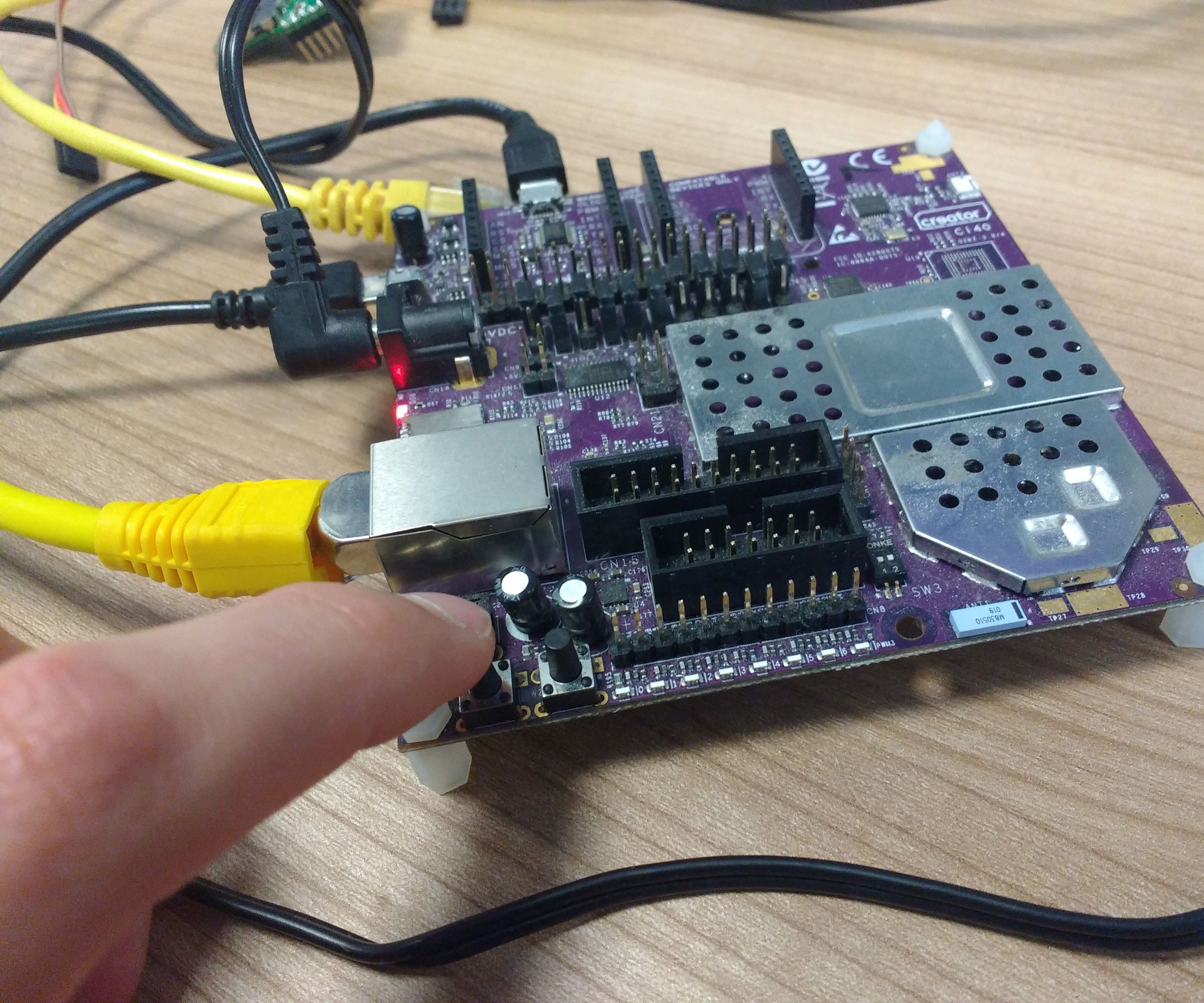

Step 2: Setting Up the Board
The first step is to connect the Creator Ci40 to a power source, a computer over USB, a USB drive containing openwrt from which to boot and the network via ethernet. To connect to the board over serial:
  • $ ls /dev/ttyU*
  • /dev/ttyUSB[x] will appear if the device is plugged in
  • sudo miniterm.py /dev/ttyUSB [x] -b 115200
  • Press enter
  • # run usbboot
  • openwrt will now boot. After new timestamps stop appearing, press enter. The openwrt logo should be displayed, along with a terminal to issue commands on the Creator Ci40
If there are any problems booting, first try pressing the reset button on the board. You will then need to press any key to prevent autoboot before the run usbboot command.

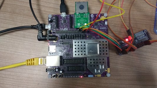

Step 4: Controlling the Robot Arm With the Joystick Click on the Board
Now the code is installed on the board, the next step is to connect the shield to the board to allow for communication between the Creator Ci40 and the servos. Writing to the servos is done using the i2c protocol, and the Raspberry Pi interface on the Creator Ci40 is used for communication between the shield and board. 4 pins are required for communication between the shield and the board:
  • A 3V supply to allow for communication between the board and servos: Pin 1 -> VCC
  • I2c data transmission: Pin 3 -> SDA
  • I2c clock: Pin 5 -> SCL
  • Ground: Pin 6 -> GND
This information is also found on page 18 of the Creator Ci40 hardware guide.
The next step is to supply power to the servos:
  • Pin 2 -> V+
  • Pin 9 -> GND
(Note that these V+ and GND pins are on the long side of the shield, not the left or right edge.)
Now you can attach the servos themselves to the board as shown. This is done with the brown wire closest to the edge of the board.
  • Left/Right -> Pin 0
  • Forward/Backward -> Pin 4
  • Claw -> Pin 12
Also connect the joystick click to the second MIKROBUS port on the Creator Ci40 (the Raspberry Pi interface to control the robotic arm is written through the first port)
Now you are ready to run the program. On the Creator Ci40:
# /usr/bin/letmecreate_examples/letmecreate_test_robot_arm
Moving the joystick will move the robotic arm. Pressing the buttons on the board will open and close the claw.

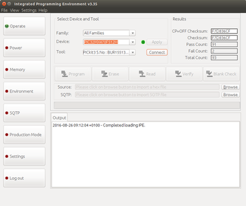

  • Plug the PICkit 3 Microchip into the USB port of the computer, and connect the PICkit 3 Microchip to the clicker using the pins on the side with the label “PICkit”. Ensure that the arrow in the PICkit is lined up to the “RST”
  • Select the device model (eg PIC32MX470F512H) and press Apply. The Tool box should now fill
  • Now click Connect to connect to the clicker

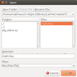

  • Now browse to the correct folder with the source code in it (LetMeCreateIOT/examples/robot_arm_client). Select the main.hex file

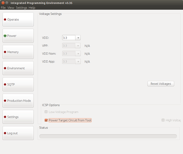

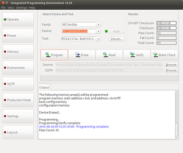

  • In Settings, enable advanced mode. In the Power tab, enable “Power Circuit from Tool”
  • Click Program

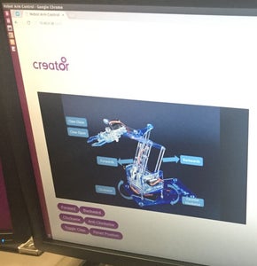

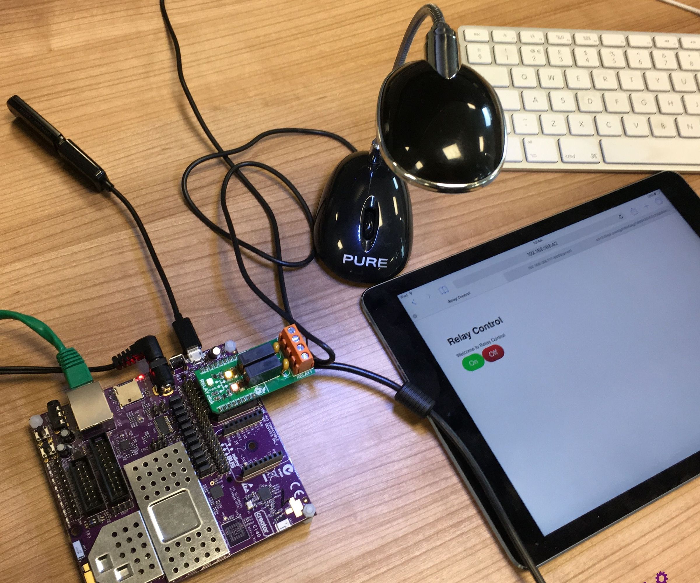

Step 6: Running a Robot Arm With a Webapp
Install git and node.js on the board:
  • # Opkg install git
  • # Opkg install node
  • # Opkg install gcc
Clone the repository somewhere on the board:
Run ifconfig to find the IP address of the board
  • servo_control/webapp# npm start
Now, with another device on the same network, open a web browser to access the webpage:
http://[Ci40 IP Address]:3000
