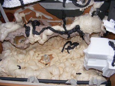

Step 11: Construction of the Bio Topic
Construction: Now we will start with construction of inner vivarium side and back replicas of tropical biotopes: first cleaning of the inside flat panels then point out the pots for plants then the foam plates and blocks and imagine the shape that you want and I hide all wood or the appearance of the clothes cabinets and lighting bulb, I use masking tape to support temporary before the foam applied on it..
Also I used some screws and nails for fixing .
In the bottom I protect the drain by masking tape and isolate all the bottom my foam in order to reduce the water effect on wood with slope to the central of the base which drain installed to take as much as of the drain water before come in the wood .. Silicon will apply after the foam dry to reduce this chance.
Types of foam used
Step 12: Construction of Bio Topic
Foam board or blocks installed inside
Step 13: Construction of the Bio Topic
Foam spray applying on the bottom
Step 14: Construction of Bio Topic
Foam applying on the foam blocks to glue and full gaps ..
Step 15: Using Tools for Shaping and Carving
After one day of construction, now I start with trimming, cutting and shaping by using my amazing PROXXON hot wire cutter and Einhell hot gun..
Cleaning and vacuum by vacuum cleaner all the waste , glue and reinstall any weak , soft or moving parts of the decoration or replica .

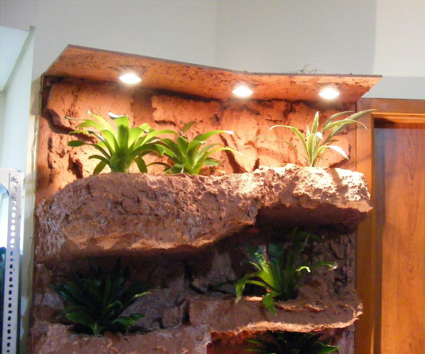

For the other side two tanks, I decided one of them (The upper one to be tropical the lower one desert terrarium)
The tropical one will be equipped with drain, light and fan as explain previously, only the lighting will be changed I used IKEA light , I need light to not taken as much as size and not release too much heat , led light used ..
The construction process will be same as main vivarium..
Step 19: Lower Tank
For the other lower tank which is the smallest one will be a desert type terrarium , I try to hide the pipe and the drain of the upper tank .. by put some foam and cover it by different colour cement and without beat moss , I used same foam spray to do that and putting only two small pots for plants ..
Lighting is by IKEA light. I like White light similar to florescent, But I cannot find it..

Finally the Big day: Now Purchase the plants and plant, arrange and water
.. Enjoy your time..
You will need beat moss , water and ceramic bubbles for drain which will be laid first , then the beat moss and then planting the plants with heavy watering ..
