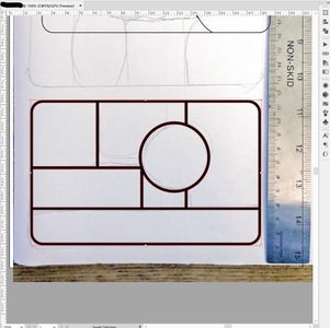

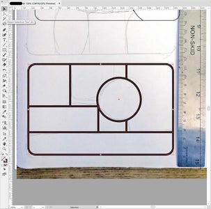

The second option is to use a vector drawing program. Take a picture of the lay-out drawing with a ruler next to it. Upload this picture to the vector program (I use Adobe Illustrator, but there are also many free options available. Choose one that can export svg-files!) and scale it to the correct size with help of the ruler in the picture. Draw over the pencil lines with vector lines. Keep in mind that each vector will be exported as a single line, so give thickness to the lines by setting the stroke to 2 mm and expanding them. Export the drawing as an svg-file and open it in Tinkercad. In Tinkercad, extrude the sketch to the height you want it to have.

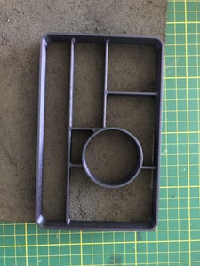

Export the inserts as stl-files, and slice with your favourite slicer, I used Cura. Standard settings with a brim should be fine!
Step 5: Make the Inserts

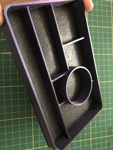

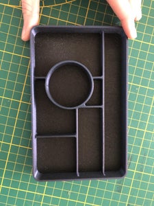

A piece of leather will be the bottom of the inserts, so the jewelry has a soft bed. Draw the outline of the insert on the leather and cut out with a sharp knife. Then use a strong glue to attach it to the bottom. Allow to dry. If you like, glue the lower insert inside the box. But mine had a pretty snug fit, so I didn't feel it was necessary. Then place your jewelry in their new home!
