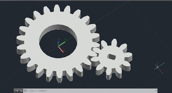

Fusion offered a 3 years licence for free, so I have taken this offer and create something awesome. With just a weekend watching tutorials, I have learned how to use Fusion to create this model right here. Because I learn as I design the model, so it's not really perfect There are things I could have done better. Also, because this model need a set of gears, I have to ask a friend of mine to design it for me. He used AutoCAD and give me the stl files of the gears, so I'm not sure how he did it.

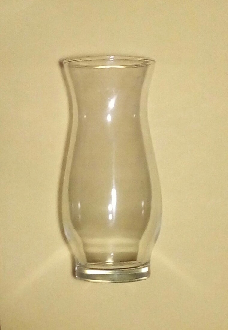

- A vase of your choice (I'm using a vase that I picked up at Dollar Tree, it's about 16.3cm tall and 7.2cm wide, you can use any vase you like, just design a spinner to fit it)

First, you'll create the object using revolve command. The main thing to keep in mind is to make the spinner large enough so that your vase can fit, don't forget to take account for the thickness of the shell. If you're planning to print the spinner in PLA, you can make it tight because PLA can be bent a little. In my case, my vase is 72mm wide, and I want the spinner to be 117mm tall, I draw the 117x38.5mm rectangle as the limit (this will rotate around the axis, so 38.5mm will give the 77mm in width. Since the spinning disk is 95mm, the base of the spinner must also be 95mm. Since it will be revolved, the bottom will be 47.5mm. Then you can draw the outline of the spinner. Finally, use the revolve command to create the object.

The smaller gear should fit over the stepper motor and the ball bearing should fit in the "spinning disk".
You'll have to use epoxy to glue the bigger gear on to the back of the "spinning disk". It's impossible to print the whole thing in one piece anyway (If you use support, it will leave rough surface).
