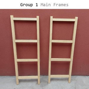

Step 1: The Main Frame of the Shoe Rack
First, we will mark our 2x4" lumber with a measuring tape and a pencil. Ensure precise measurements for all dimensions because this frame must be robust enough to provide sturdy support for the shoe racks that will accommodate your footwear collection.
Mark your longest 2"X 2" - 44.5" Length lumber evenly from the inside where your small 2"X 2" - 13" length will be placed. The small lumber must have a mark in the middle to carefully drill and screw onto the longest lumber. It should look like a ladder. Look at the "Group 1" image.
Prior to drilling, it's essential to verify your measurements, especially since you'll be constructing two identical frames that must align perfectly in terms of height and the spacing between each lumber piece. We strongly advise using the appropriate drill bit for securing 2 1/2" screws.
With the last grill assembled you’ll have the sides of your shoe rack ready.

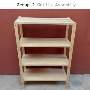

Step 2: Building the Grills of Our Shoe Rack
Now, it's time to assemble the four grids that constitute the rack. Taking your time and being exceptionally precise when measuring and cutting the lumber is crucial in this step. This meticulous approach will result in a visually pleasing rack with improved durability.
To begin, start with the lower grid. We recommend cutting your 2x4" lumber in groups of three, each with a length of 35". Mark two points at each end as your guidelines for careful attachment to the previously created side frames. Ensure even placement and securely fasten them to your 2"x2" lumber, which should be 13" long. For this particular step, we suggest using 2" nails.
