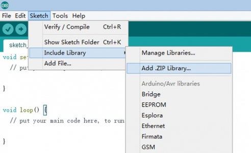

Step 2: Install the Library for I2C_LCD
Download the I2C_LCD Library from I2C LCD wiki page(chapter--How to use?) and install it to Arduino IDE.
Open Arduino IDE, click Sketch -> Include Library -> Add .ZIP Library.
