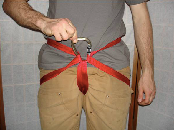

Step 6: Pick Up the Harness
On next page You can see a full instruction on how to do this step by step.

Step 7: How to Pick Up Single Rope Harness
