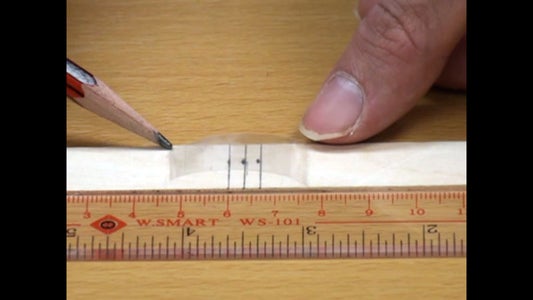

1) Measure the width / diameter of the axle
2) Draw the marks on the plank indicating the center of the plank and the width / diameter of the axle

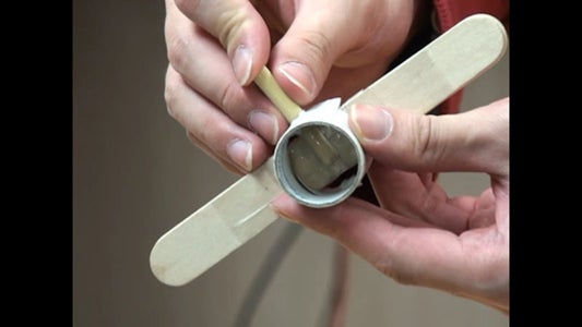

3) Make the axle retainer by several sealer tapes:
- one short sealer tape with its sticky side facing the sticky side of the middle region of another longer sealer tape
- attach the longer sealer tape to the plank (centered)
- two same sized sealer tape wrap around the longer sealer tape (as close to the rim of the axle as possible)
Note: The axle may be placed at the center of the plank to assist positioning

Step 5: Assembling the Parts
1) Test and try fitting the parts. If the parts are not fit, then modifications are needed
2) Place the plank into the plank slot of the seesaw base
3) Put the axle through the axle slot (holes) of the seesaw base
Caution: When penetrating the axle through the axle slot of the base and the axle retainer of the plank, keep an eye on the penetration as the axle retainer may be damaged by the axle

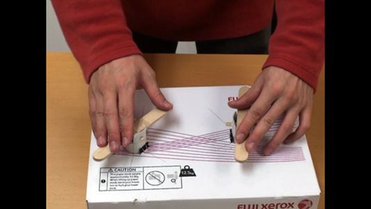

Step 7: Results
After applying pressure and loads on the desktop seesaw (2 sides), the seesaw system works well (e.g. rotate smoothly) and did not fail (e.g. fall down, crack or collapse), even hit by a certain amount of mechanical forces (unpublished data).
The system has also passed the loading test using weights ranged from 500g to 750g per side (i.e. up to 1.5kg total weight).
Interestingly, the sealer-tape-made axle retainer has a better endurance than we previously thought (i.e. no cracks or obvious signs of damage resulted from rapid and loaded rotation).
