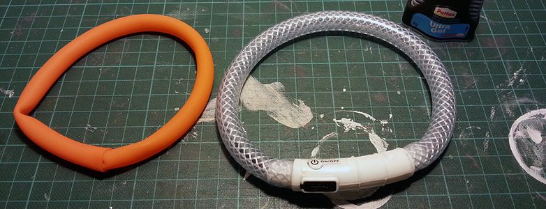

We bought a LED collar for our small jack russell terrier. The decision was made because battery can be charged via USB, it is waterproof, and the collar sizes can be adjusted universally from 20cm - 70cm.

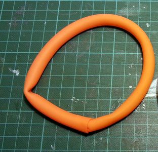

But when we shorted the collar an uggly bend appeard in the rubber tube because the tube was too soft. We decided to improve the collar by changing the tubing. This tutorial shows you how this was done.

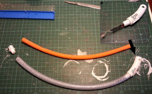

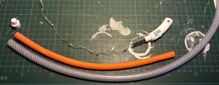

Step 2: Disassemble the Orginal Collar

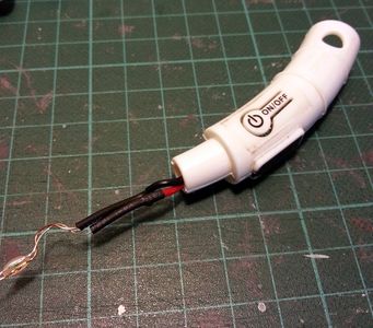

First you have to carefully open the collar to take the led stripe out. I used the cutter to loosen the white end cap and the part with the powe button and the usb charging interface.

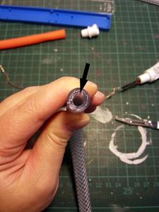

Step 3: Preparing the New Tube
As you can see on the photos, most of the stability from the fishkeeping tube comes from the double-walled construction. This is nice and what we want but the original end cap and the part with the usb interface will not fit anymore.

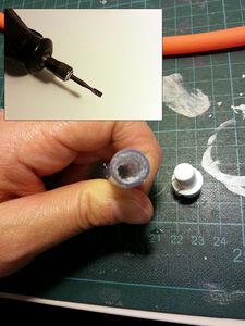

Use a Dremel or any similar drilling tool to remove some of the inner wall to make the original parts fit again. You can measure the diameter or you can just drill and try. But be carefull not to take away to much of the material.
Step 4: Assembling New Tubing
Next, you can slit the LED stripe inside the new tube. Be carefull not to bend or break the wire. Make sure the original white parts fits tightly inside the tube. After you are sure everything is fine, glue parts in place.

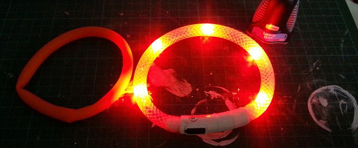

Step 5: Finished LED Collar
Here is the result. It took me half an hour to make the collar. I am very pleased with the result. The collar works very well and is very robust! No LED failure after one winter.
