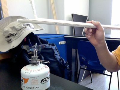

Now cut the 1" PVC pipe into four segments: 2×2.5m (top) and 2×2.7m (bottom). These four segments will become the boat's structural frame. Cut each end of the pipe 45 degrees.
Then, cut the 0.5" PVC pipe into: 2×70cm, 2×60cm, 4×35cm, 2×40cm. These segments will become the supporting frame?. Now, take each of the supporting frame and make "legs" on each side. Look at the pictures to see how to make them.

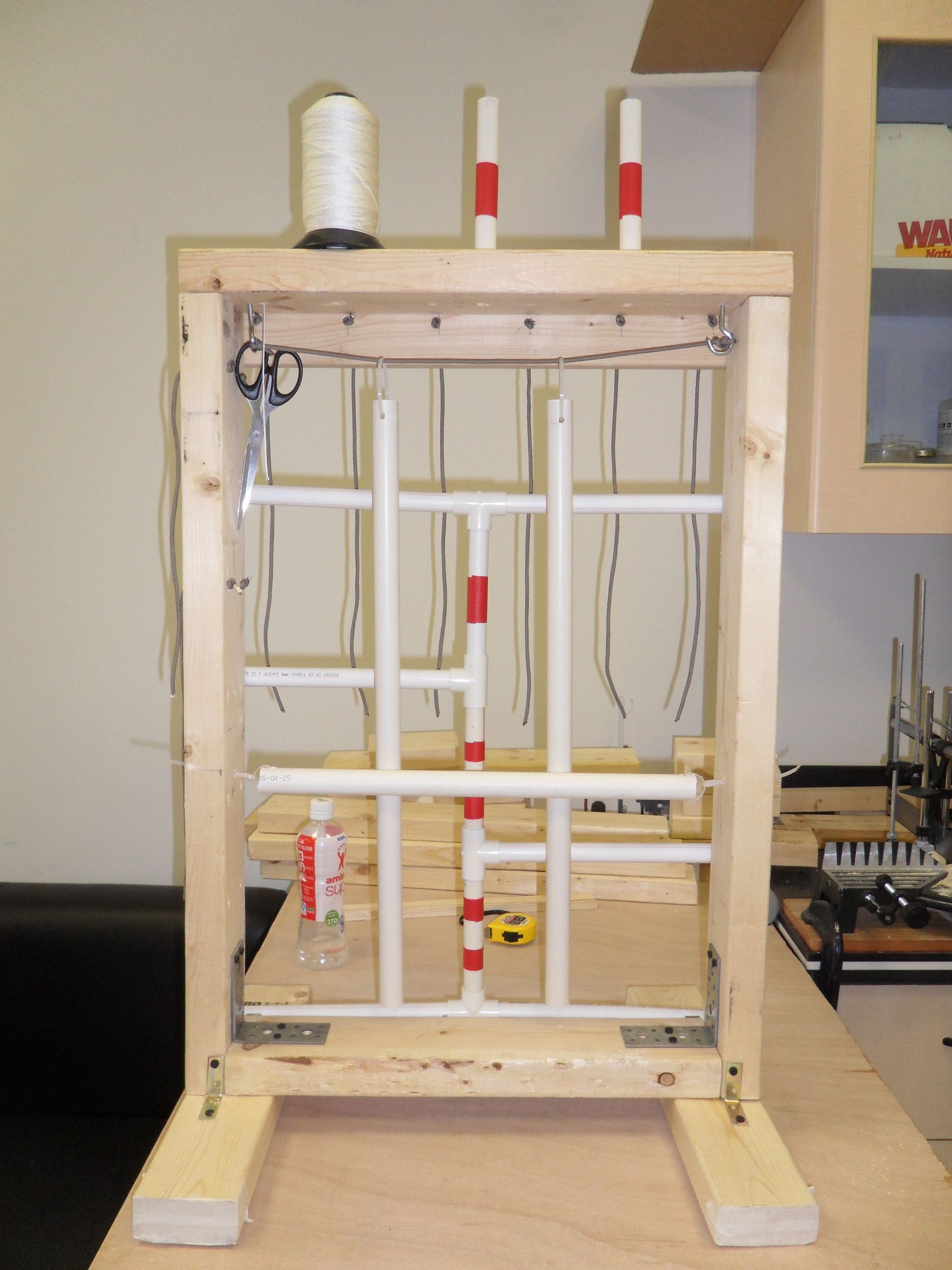

Next up: add supporting frame segments. Since it's hard to describe it, I scanned a diagram showing how to do this.
The credit for this frame idea goes to hydroc346.

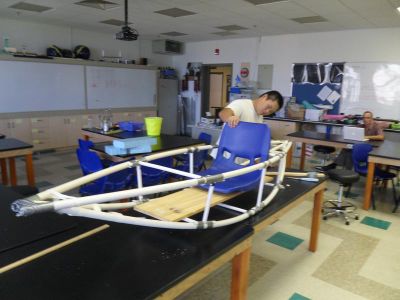

Step 3: Attach Chair and Foam
You want to be able to sit on the kayak, so this step describes how to attach a chair to your frame.

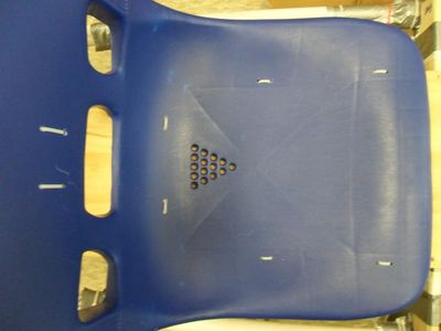

First, take a wooden plank and drill several holes, then zip-tie it to the bottom supporting frames. Drill some holes through the chair and the plank, then use zip-tie to secure the chair into place.
You need some material to fill up the vacant space under the wooden plank, so I added some blue foam and simply hot-glued it in place.

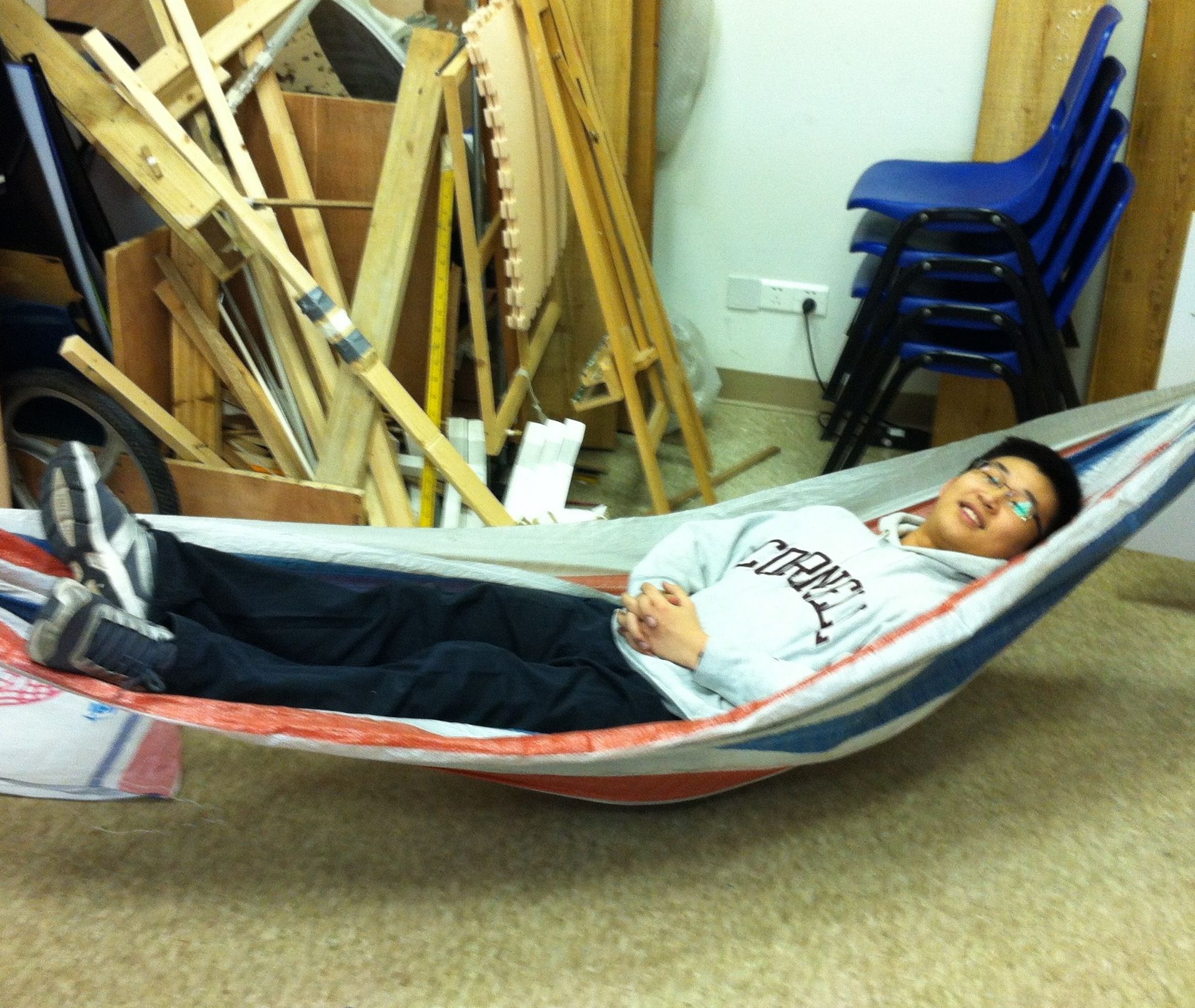

Flip the kayak over, then place tarp over the kayak diagonally (or parallel, if your tarp is large enough). Make sure that the tarp is waterproof BEFORE you put it on. Lay the tarp diagonally, then fold in any excess flaps into the kayak.
Tape the front and the back tips, then zip-tie the tarp onto the frame. (if your tarp has loopholes). If it doesn't have rings, you can either simply tape it onto the frame or make holes using a hole puncher.
Flatten out the tarp as much as possible to prevent it from looking too much like a garbage can.
After you're done wrapping the kayak with tarp, add some foam on the bottom of the tarp so that the bottom doesn't get scratched up.

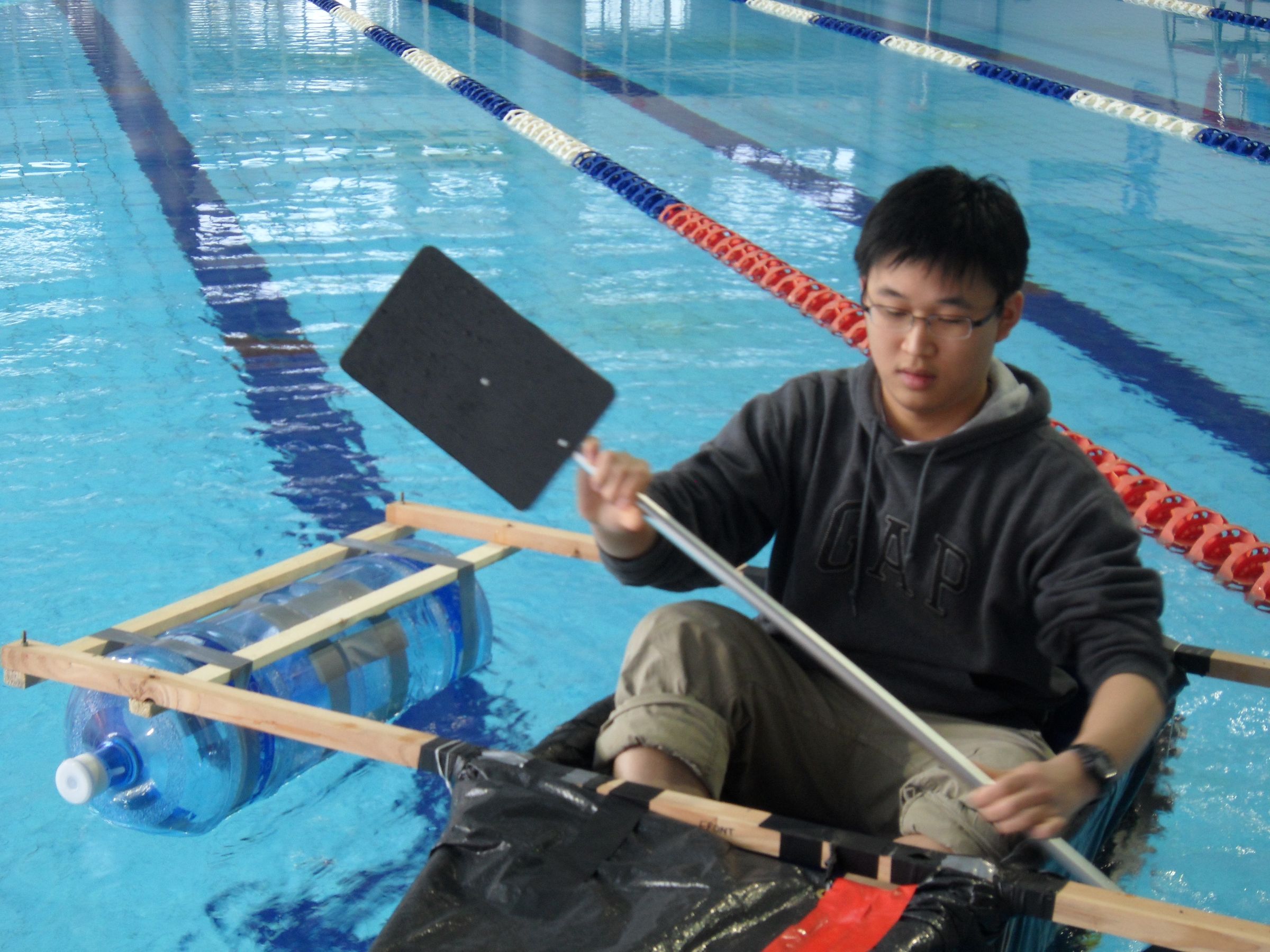

You may want to attach outriggers if you think your boat is too unstable. Simply attach 4 water dispenser bottles on each side (having outriggers on one side works too).
Although the boat becomes very stable, there are some trade-offs. It's harder to paddle the kayak as you have little space. However, you can utilize the outriggers as storage area - rope, fishing line, etc. I'm also thinking of using velcro to make detachable flashlight, compass. etc.
Step 7: Test It Out!
I tested it out in the school pool - coach George let us use two lanes :D
I first tested it out without the outriggers - it was rideable, but was somewhat unstable and I had to spend a lot of energy trying to balance.
With the outriggers, it was much more stable - I could stand on the kayak and not flip the kayak. Don't lean backwards too much though; water might get in through the back. One suggestion I have for you is have the chair placed more in the front, moving the center of gravity to the front so that the kayak won't be tilted so much.
