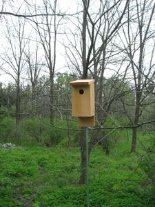

Step 8: Mounting
Now to select a good location for your bluebird houses, consult the following resources:
Once you have selected a location, get a stepladder and your sledgehammer and carefully pound the conduit deep into the ground. The entrance should be between 5 and 7 feet off the ground, so a 10' conduit is going to need about 4' of pounding. Be patient and careful, don't damage your fingers or fall off the ladder! You almost certainly will benefit from having someone else help you here, at lease to hold the ladder. I am not responsible for your safety. Use common sense!
With the conduit in the ground, go ahead and mount the C clamps directly to the bird house in place. Make sure that the clamps are holding all of the weight and it resists spinning on the conduit.
I placed the houses 10' apart on the edge of a field with some bushes and a small tree about 50' away, with mowed grass in between.
