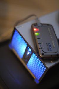

Bokeh is a term for the quality of out-of-focus light in a photograph. One interesting effect is that points or small areas of light that aren't in focus take on the shape of the aperture they pass through on the way to the film (or digital sensor). This instructable will show you how to easily make the highlights into interesting shapes.
Camera lenses control the amount of light that passes through them by making a hole (the "aperture") larger or smaller. They usually do that by moving a set of metal blades (check out this trippy animated gif ). You can count the number of blades for many lenses by looking at the shape that a point of light becomes when it's out of focus. My 50mm lens produces a 7-sided figure (a heptagon).

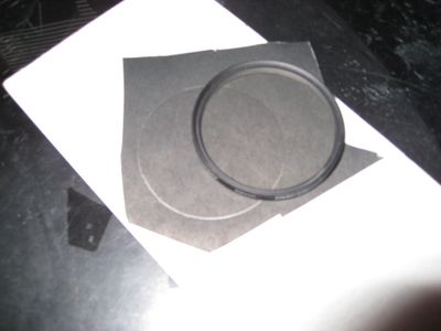

Step 2: Cut Paper to Fit Inside the Filter Ring
Trace the shape of the filter screw threads on a sheet of paper, and then cut it out.
If you don't have a filter, you can trace the front of your lens and then cut a bit inside the line.

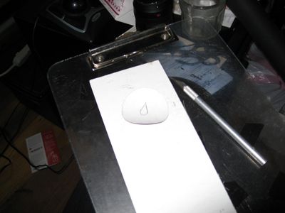

Step 3: Cut Shape
Cut a shape into the center of the paper

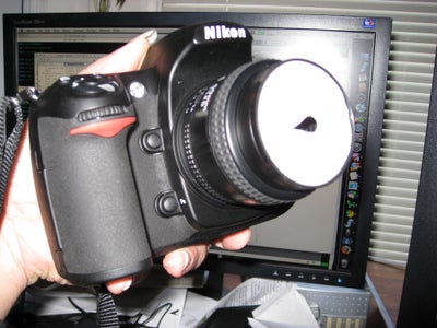

Step 4: Pop the Paper Into the Screw Threads
Because you traced the edge of the threads to cut it, the paper should be a little bit bigger than the threading, which will make it stay snugly in the filter threads.
I recommend that you put the filter on the lens and put the paper in the screw threads of the filter instead of the screw threads of the lens. Much better to scratch or get fingerprints on an easily cleaned/replaced filter than your lens.
If the shape screen doesn't fit snugly, you can put it between the filter and the lens, and screw the filter into place, trapping it. But then you won't be able to easily adjust its direction.

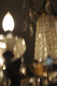

Try it out. Set the camera to the maximum aperture (smallest f-number), and use the shutter speed to control the exposure. It may help to focus manually. Shooting highlights or small light sources against a dark background is the easiest way to see the effect.
One neat effect is that if some highlights are out of focus because they're too close and others are out of focus because they're too far away, they'll have bokeh shapes that point in opposite directions.
