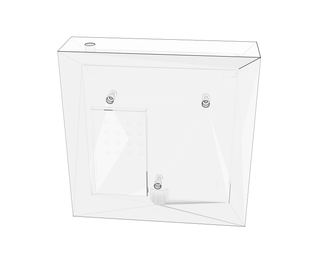

Step 6: Gluing Cube
Line out 6 workpieces so that they match schematic in the picture so you won't mess up anything.
Take wooden glue and brush. Apply glue on the first 4 workpieces that are going to make sides of the cube. Then try to put them together. Do it fast so the glue doesn't dry.
When all 4 workpieces are holding lightly together, take painters tape and start to wrap around the cube. At the first do it without force just to get all workpieces to hold together and the slightly increase force how strong you tighten workpieces together.
The reason why we use painters tape because it is cheap and when we tried to use jaws it was very easy to get them too tight and then the cubes will come out more like rectangular parallelepiped.
Then take 5th workpiece, apply glue on it and all 4 sides where you are going to place it and put it in place.
Also, take 6th workpiece but don't put glue on it, because later we will solder the light cube inside through that spot. Put it in just to wrap painters tape around and there are no sharp edges.
Apply painters tape to all 3 dimensions and then with the help of fingers straighten the cube by pressing edges and corners together if that is necessary.
Let the cube sit there for one day.
