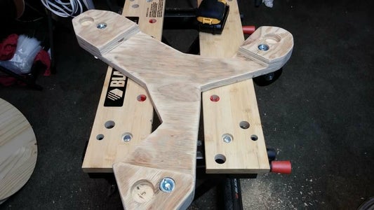

For this step I put the tripod on the chunk of plywood and made marks with a straight edge. I was not using any rhyme or reason really when making my marks. I wanted to make a kind of Y shape. The entire shape did not turn out to be as symmetrical as I would have liked, but I am going to stick with it. I am using scrap wood that was just barely big enough, so that is my excuse. I cut the dolly out of the chunk using my circular saw and the jig saw.
Step 3: Glue and Trim
I wanted the "tips" of the Y shape to be thicker so that I could drill the holes in the "tips". So I had the shape that I wanted, so I cut the leftover pieces into a little bit bigger pieces than the tips. That last sentence was rough,, lol. OK so the idea is, cut the pieces bigger than the original, glue to original, wait, and cut off extra. There, that is the idea. Just look at the pictures, they explain it better than my 1000 words.
I also tried to fill all of the voids in the plywood with a mix of wood glue and sawdust. I dont think that it works as well as epoxy. I think in the future I will use epoxy to fill plywood voids.
Step 4: Sand and Drill
I sanded this a LOT. I used different grit of sandpaper starting at 80 grit and working up to 220 grit.
Once I was happy with the smoothness of the dolly I moved on to the holes where the tripod will sit into. i put the tripod on the dolly and marked the holes. then I used a 1 3/8in Forstner bit to make a hole about 3/4in deep. Then I drilled another 3/4in hole 3/4in deep for the wheel nuts. I used a 3/8 drill bit to drill all of the way through the center of the 3/4in hole. That way the bolt for the wheels could pass through.
Step 5: Attach Wheels and Epoxy Holes
I attached the wheels and made sure that all of the nuts for the wheels were countersunk enough so that I could epoxy over the nuts and make it flush with the wood. I tightened the wheels as tight as I could without breaking through the wood.
I Mixed up some 5 min epoxy and poured it into the voids left above the wheel nuts. After waiting a couple hours it was set enough so that I felt comfortable sanding the epoxy level with the wood.. I am altogether happy with the way that the epoxy turned out, but I noticed that there were a lot of air bubbles in the epoxy so that when I sanded it down it was not perfect. I am not sure how to avoid this. I will have to try different method in the future to achieve the best result.
