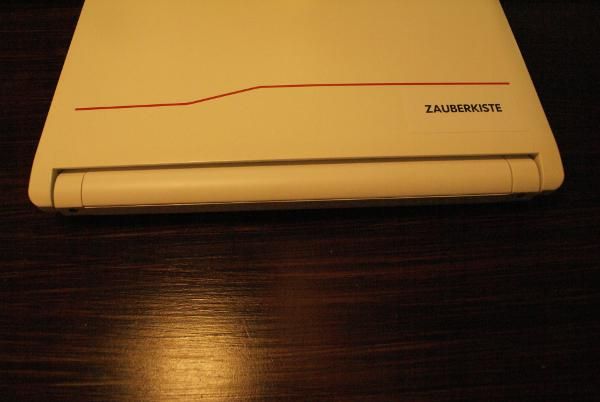

Since I work in a small flat with no separate space for handcrafts i struggle always with building before and cleaning up afterwards just for simple electronic work. There were always the same tools to search in boxes and cases, plug them in, find wires and solderin tin and so on. So for only 5 minutes work comes together just an hour or so for the setup time. For me the solution was a box where everything can be found at the same space where it belongs to.
Simple philosophy: Everything has a space, everything has its own space.
This Instructable should be more a watchable, because for myself I don't read the long text instructables. But I believe I took around 80 pictures that give you an Idea what could be done and how to do the important parts. If there are any questions left, just put them in the comments.

So I begin with the heavy thing, the power-supply put it in the middle and arranged everything around it in mind and constructed everything in sketchup. It need to fit on the desk and on the storage-space.
Since I don't move much around with that stuff and have a lot of wood waste I didn't bother weight. So I took a mix of hardwood (for main support frame), plywood, MDF and 3mm HDF and mainly express-wood-glue and a mix of screws.
I will not give measurements here, because every part is fitted around what needs to be put inside the box and where it should be stored. The tunnel for the fume should be at least 12x12mm.

Step 8: Done!
So here's the result
