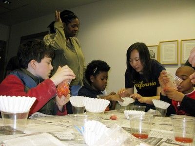

Step 4: Step 2:
2) Mash the strawberry in the bag without creating too many bubbles for 2 minutes, making sure the consistency is somewhat uniform.
Step 5: Step 3:

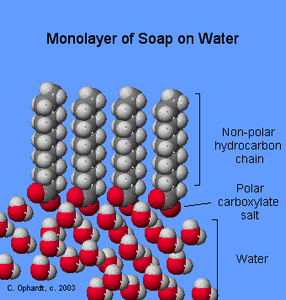

3) Measure 10 mL of a buffer solution, which is soapy salty water. ( 5 mL dish washing soap, 5 mL water, pinch of salt) Add the buffer solution into the bag.
Step 6: Step 4:
4) Mash the strawberry again for 1 minute, trying not to make too many bubbles.
Step 7: Step 5:
5) Set up filter and filter the contents into a beaker. Discard the pulp and filter after obtaining the liquid.

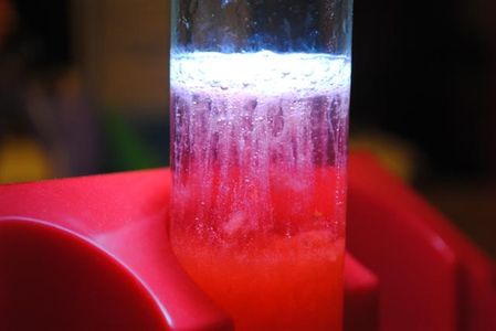

7) Obtain 40 mL of ice cold ethanol and slowly pipet the ethanol down the side of the test tube with the extract.
Step 10: Step 8:
8) Wait for the ethanol and extract to form layers, with the ethanol laying above.
Step 11: Step 9:
9) Gently twirl the glass stirring rod just below the ethanol layer and carefully observe the DNA precipitate. Try to spool up as much as possible and carefully remove from the beaker.
