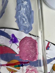

Next, I played with the colors. I tested colors on a clear glass casserole pan, some glass plates to see how they dried and tested mixing colors for a realistic effect.
- Try a blob of paint and drop a few dots of white on top. Then swirl around the white with a toothpick.
- Do the same using a shimmer/metallic paint and that looks cool when dry!
- Adding a few drops of darker paint to the lighter shade of the same color gives a little dimension to the color
- Combine white to any color and mix good to create a lighter color.
- Apply a dark color and add white to one end then 'pull' the color up through the darker color with a toothpick to give it a shaded effect.

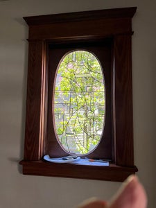

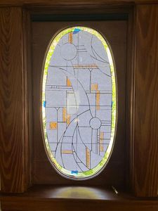

Step 5: Tape Design to Window, Apply Leading

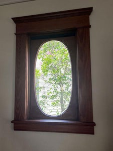

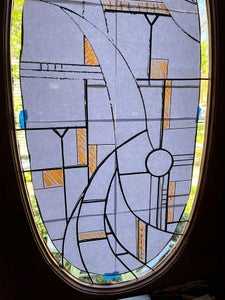

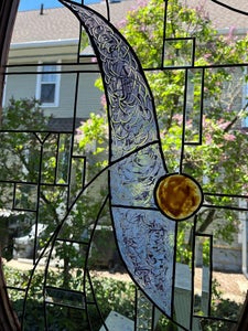

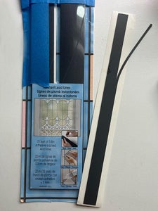

The first photo shows the beautiful window before I 'stained' it. After cleaning the window REALLY WELL, I trimmed my design and taped it to the outside of the window (Pic 2). This way I could follow the outline to lay my leading. The leading strips (Pic 3) are really easy to work with, they are flexible and stick to the window well. I started laying the leading lines directly on the window, following my 'template'. My printed design didn’t quite fit to the edges so I extended the leading all the way to the window edges (Pic 4 & 5). The leading lines are easy to trim with an exacto knife or razor, when placing them.
When all lines were in place, I used the orange areas I marked on my template to see where I wanted to place the bevels. I glued my glass bevels in place using one tiny drop of Loctite glue on each end of the bevel. I butted them right up against the leading lines, pressed and held in place for about a minute. They held well!.
As a finishing touch, I went over my design and put a dot of Liquid Leading (also from Gallery Glass) at the intersections of my leading lines. This closed any gaps and gave it a realistic touch, just like actual stained glass!
When all bevels and leading where in place, I removed the template from the outside of the window (Pics 6 & 7). Beautiful!!

I took a little stipple brush and/or my finger to fill in the section fully. Make sure you get the paint all the way up to the leading lines. If the paint started to drag down too much, I kept brushing it back up as it dried so it didn't 'pool' at the bottom. The paint starts drying fairly quick, so it worked with me.
After it started to thicken, within just a few minutes, I started to add texture to the section. I made texture using my brushes, paperclip, toothpicks, my finger and any other little ‘tool’ I had, to make vertical, horizontal and/or diagonal lines in the paint as it dried. For the circles, I used one of my test paint patterns and colored it in with Amber and swirled in Cocoa Brown to give it dimension. In other areas, I swirled in different colors to give them more interest. Most areas I kept clear, just using different textures.

Step 7: Enjoy Your Window!

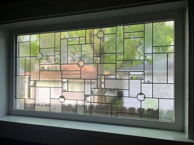

I takes about 2 days to completely dry, depending on how thick the paint was laid on. Once its dry, it can be cleaned with Windex and paper towels, using a light hand. I used color for this window, but I also have done windows using just 'clear' and a lot of different textures (Pic 3). Overall, I think they both turned out to be really close to the real thing!
Thanks for checking out the project and if you decide to try it, have fun!!
