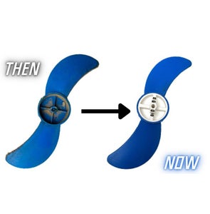

In this instructables, I am going to repair my old table fan. As the summer season is approaching in my home town so I have to make arrangements for it. I remembered my old mini table fan with broken blade hub. I found this fan in my junkyard. Now I have a 3D printer so I got an idea to repair my fan blades with a 3D printed hub. If you repair something then you are reducing waste and helps environment. So I started to repair my table fan and sharing this tutorial with you.

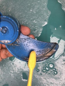

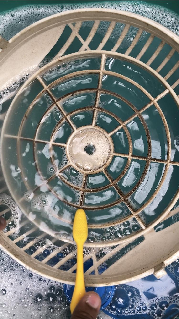

Clean and Inspect Components: Once disassembled, you can clean the individual components of the fan, such as the blades, grills, and motor housing. Remove grease and oily substance from the shaft of the motor with the help of sand paper. Use detergent powder and a soft brush or cloth to remove dust and debris. Inspect each component for any signs of damage or wear.

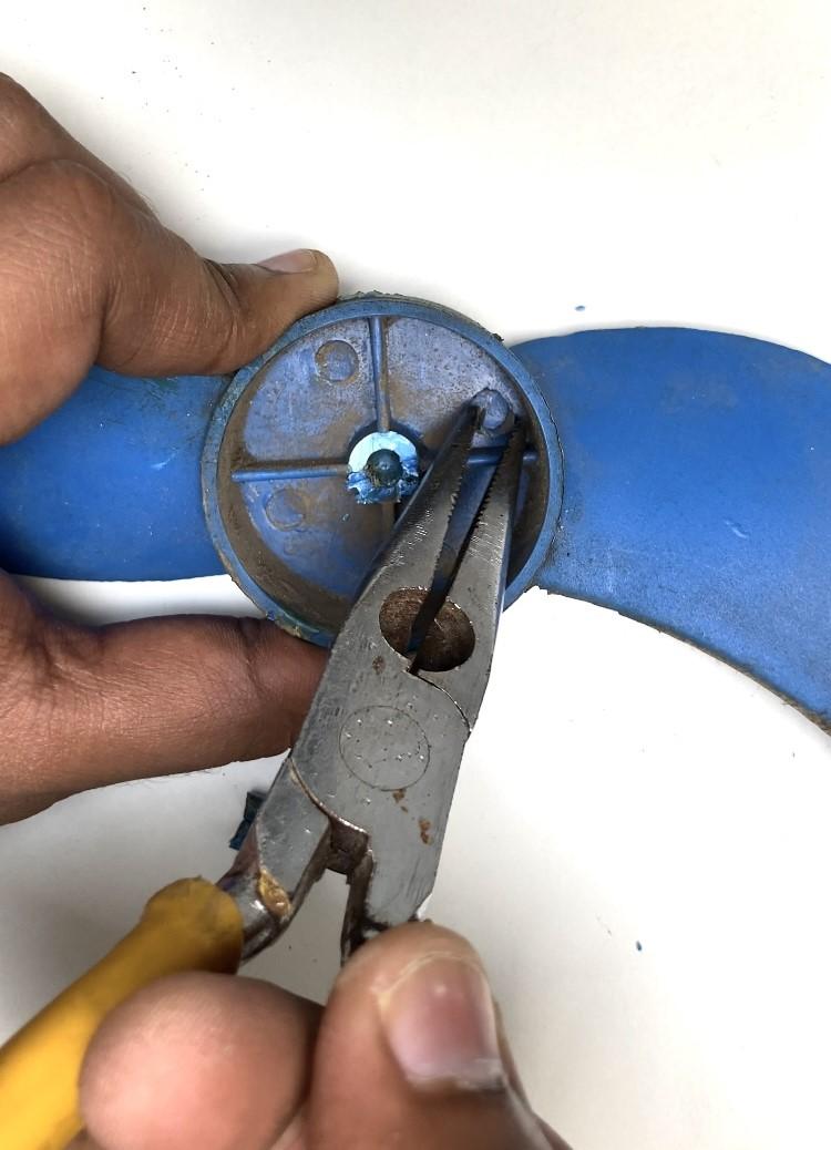

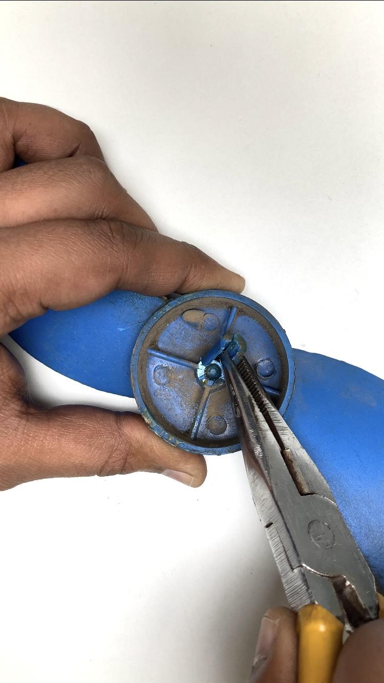

Cleaning blade hub: The hub of the blade consists of broken hole and their residue parts. So I have to remove these residue parts with the help of long nose pliers. Care should be taken while removing the residue parts as it may damage the blades. After removing the residue parts clean the hub with the help of sand paper.

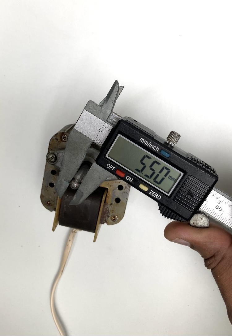

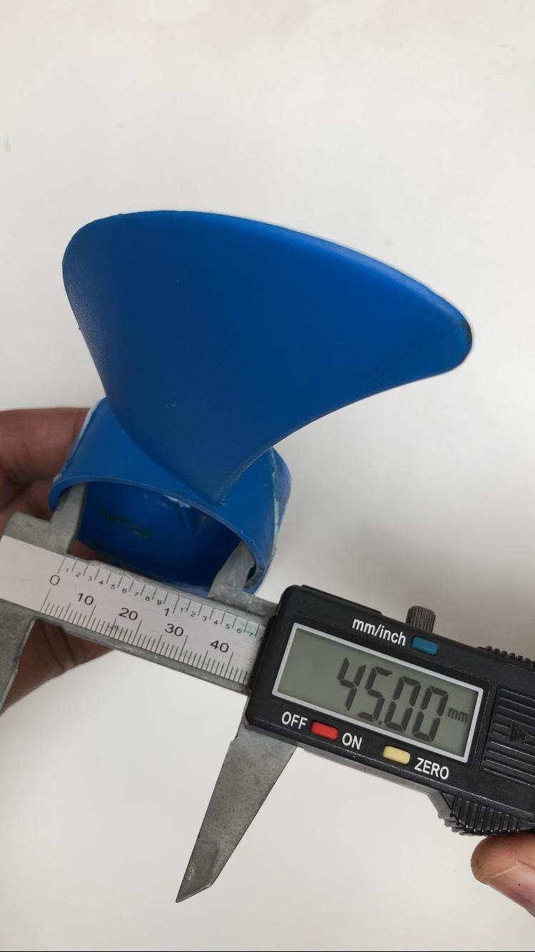

Dimension measurements: I used Digital Vernier Calliper and a measuring ruler to measure the diameter of the shaft of the motor, inside diameter of the hub and the depth of the hub. After taking measurements I prepared the 3D model on the Tinkercad. The dimensions are:
  • Shaft Diameter = 5.50mm
  • Inside Diameter of hub = 45mm
  • Depth of hub = 12mm

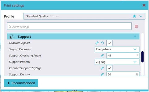

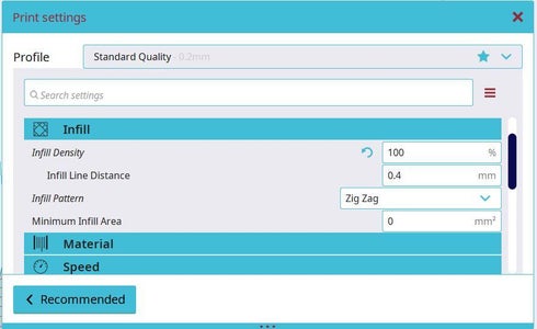

Printing Process: Set up your 3D printer and load the design file. Adjust the printer settings for the chosen material and print the blade. Make sure to print with enough infill for strength, especially near the hub. The slicing software settings are shown in the images.

Check the wires and the switch of the fan. Make sure that there is no cut on the cable and if the connections on the switch (it is found in my table fan) are broken then solder them properly. Once reassembled, plug in the fan and test it to ensure everything is working properly. Listen for any unusual noises or vibrations that may indicate a problem. My table fan is now working properly without any noise.
