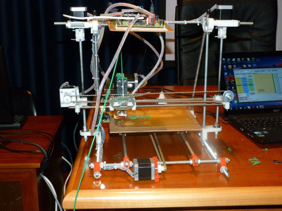

The Premises
The RepRap Prusa has an intuitive design and a system of simple and easy assembly, the plastic parts that make up the structure are easy to handle and require no great difficulty in mounting them with the mechanical structure, and allow to obtain results even without linear bearings and other benefits . The final structure is solid and makes it easy to transport thanks to low weight.
Bigger Dimension
The first step was to increase the size of printable area.La structure has been developed in such a manner so as to have more space to print.
Cheaper Structure
Another significant change has affected the mechanical structure of the new printer.It was find a new structure that could use a smaller number of pieces and always have a solid one .Similar to the mechanical also plastic parts have also been modified where possible or completely renovated. all this has led to savings in economic terms but also in terms of time required to assemble the printer itself
Open Design
The structure of the new printer is made to have an open design that allow subsequent changes in every part, also the X-cart which moves the extruder-it was so designed as to be universal and can be used with any type of extruder .The 'print area is easily accessible for a heated bed or in order to analyze the subject in print a
Benefits of the model:
Quick and easy to assemble Model
Spare plastic Intuitive: easy to assemble and print
Number less than threaded rods
Number less than smooth bars
Amount less hardware
Belts shorter
Open Design
Extruder in view
X-Cart is compatible with all types of extruders available
Printing area easily accessible
Print the objects in view

Step 1: Required Parts
The Plastics Parts are made of:
Green Block':
2 x Z Motor Mount
4 x Giunto Motore
White Block:
4 x Blocca Barra
1 x Supporto Motore XZ
1 x Porta Cuscinetto 608
1 x Supporto XZ
2 x Supporto cuscinetto 608 XZ
Red Block:
2 x Piede
2 x Vertice Basso
2 x Vertice Alto
2 x Bushing
1 x Carrello X
4 x Barclamp
4 x Beltclamp
2 x Puleggie T5 8 denti
1 x Supporto Motore Y
3 x Endstop
You can download all the parts here or send an email to kentstrapper@gmail.com to buy it
Mecchanics
Threated Rods :
4x M8x300mm
4x M8x420 mm barre
2xM8x335mm
1x M8x470mm
1x M8x50mm threaded
2xM8x160mm
Smooth Rod:
2x 8mmx440mm barra liscia
2x 8mmx390mm barra liscia
Vitamins
12 M3x20 bolt
3 M3 x 15bolt
70 nut M8
8 washer M8
3 wahser M8 x 30
4 x M3 x 40bolt
4 springs M3
32 washer M3
32 nut M3
9 x M3x25 bolt
2x M3x 30 bolt
11 x M3 x 10 bolt
6xM4 nut
xM4 x 20 bolt
2 x screw M3 x 10
Belts
1x 840mmx5mm T5 pitch timing cinghia -misure standard prusa mendel-
1x 1380mmx5mm T5 pitch timing cinghia -misure standard prusa mendel-
Bearings
4 x 608 ZZ bearings
