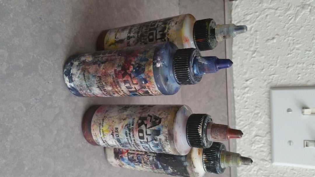

Step 1: Materials
Here's what you need to get started. You can find these tools at your local artist's supply store or online:
  • Linoleum cutter and blades
  • Artist's linoleum
  • slow-drying paint or printing ink (I personally use Akua monotype inks when I make hand-painted prints)
  • paper
If you prefer printing by brayer:
  • Block printing ink
  • Brayer
Helpful hints:

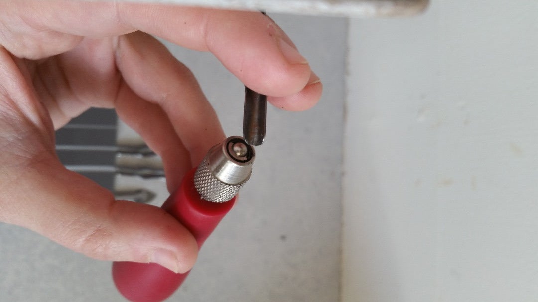

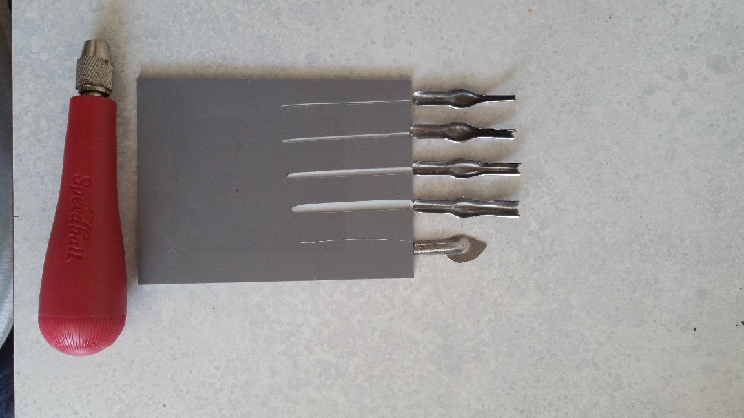

  • Speedball produces a nice linoleum cutter kit that includes a handle and several interchangeable blades. The blades vary in size and produce different types of cuts, from fine, delicate cuts ideal for detail, to broader, shovel-like ones better suited to carving out larger areas of material.
  • Artist's linoleum is available in a variety of grades, from very soft, eraser-like textures to firmer surfaces. If you're just starting out, use the softer grade. If you'd like to create more detailed images, use a firmer texture.
  • A whole spectrum of colors is available in printing ink nowadays, but if you want to be economical I recommend getting just the three primary colors (red, yellow, blue), black, and white, and mixing different colors yourself. I'd also suggest getting water-soluble ink, as this is easier to clean. To minimize mess I put my ink on my piece of Plexiglas.
  • Paper: You can use all kinds of paper for printing, but you'll want something strong enough to handle the pressure of your hand rubbing over it.

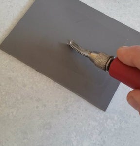

Helpful hints for carving:
  • When carving, apply mild to moderate pressure to move the blade forward and through the linoleum. Be sure to carve away from your body at all times.
  • Linoleum blades are very sharp, and you don't want to accidentally cut yourself.When carving out large areas, try overlapping your cuts to ensure that you've carved out the area thoroughly.

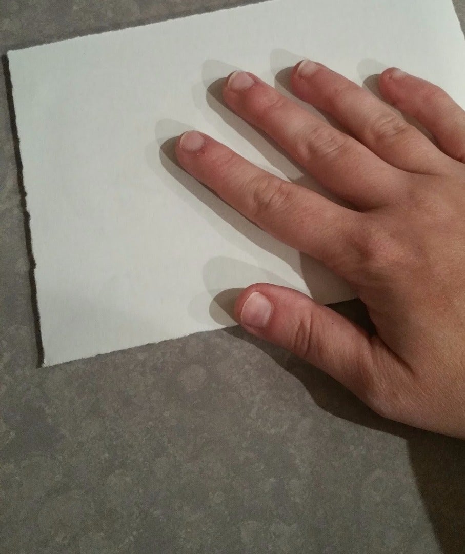

Helpful hints for printing:
  • Lay a piece of paper over the block. Rub the paper by hand to transfer the image.
  • Since you'll be printing multiple blocks on the same sheet of paper, you'll want to make sure that each block is placed in the exact same area on your paper, otherwise the print will look messy. This alignment is called registration. To help ensure registration, take a pencil and draw around one of the corners of the first printing block. When you print subsequent blocks, you can line them up with the corner you traced to make sure they all are printed in the same place. As you print your blocks, the outline of the block shape will also leave an impression on the paper, which can help you guide your blocks into the same spot.
  • You can use either damp or dry paper for printing. Dry paper usually involves more rubbing and ink for a successful printing.
  • If you don't want to use your hands, you can also set the block on the floor, stand on it, and rub the paper with your feet. If you try this, make sure you're wearing socks, otherwise your feet might stick to the paper.If you're printing multiples, or an edition, I recommend printing your edition one color at a time rather than making an entire print all at once. That way you only need to mix one color per printing session, and your ink has time to dry between printings.

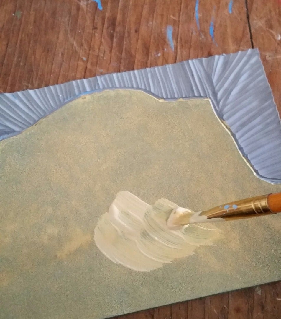

Once you've printed your first color, it's time to carve out the areas of the block that you want to stay that color. Once you've done that, print the remainder of the block with the second color.
If you're hand-painting your blocks, feel free to try out different brushstrokes and textures to add visual interest to your prints. For these prints, I used Akua inks, but you can also use oil paints or other slow-drying inks. For this print, I printed the church twice. For the first printing I used sweeping brushstrokes to give a sense of movement, while for the second printing I used more dappled brushwork to suggest the adobe exterior of the church.
