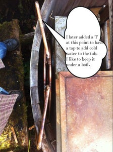

The copper coil comes almost how we want it. First I slipped two lengths of straight pipe between the layers of the coil to help see what was what. I then bent the center a little tighter and worked my way out expanding the coil on one side to make the coil lay with about 1/2" spacing, flipped it over, then expanded the other side.
The two spacing pipes are just long enough so they don't touch the bottom of the tub.
A 90 degree elbow is put on the bottom of each spacing pipe and one is attached to each end of the coil.
After making sure all pipe is clean and flux is on at all the contact points, I think it would have been easier to solder, if I had used two boards and clamps to sandwich the coils tight against the straight pipes. I didn't and it worked but one or two wanted to jump away when I turned it over and soldered the other side.
A 90 degree elbow is then placed on the top end of the spacer pipes and with the coil held in place in the tub, find the angle that they need to be at, to hold the coil on the side of the tub.
I chose to have the pipes go out to the sides so they were not right in front of where you stand when stoking the fire.

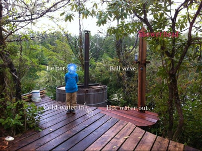

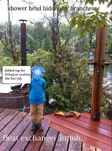

So the ends go out of the tub, down the side to a 45 degree elbow (so there is room for your fingers, between tub and pipe, when attaching the hose) and the garden hose adaptors.
Cold water in, warm water out to shower head. There is no mixing of hot and cold for the shower, there is just a ball valve in line for on or off.
Step 3: Bonus Deck
So now when the hot tub is in use, we have a hot shower that is the perfect temperature and you will run out of water before you get a cold shower. If the shower is too hot then so is the tub.
