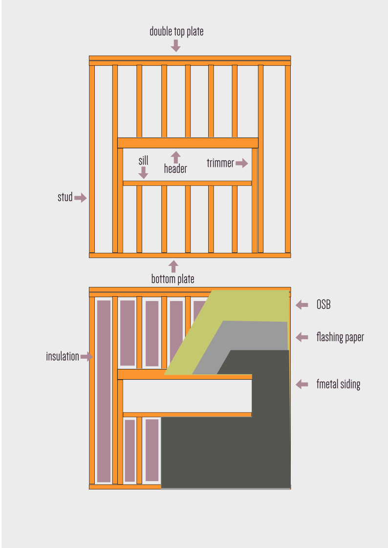

The five different external walls have a similar skeleton. Each is built upon a 2x6 bottom plate. The double top plate, necessary because of the hydroponic garden, uses two boards of the same size. The wall studs (2x4) are spaced a foot apart. The wall sheathing, which prevents swaying and bending, is made of 7/16” OSB. Flashing paper is added above the sheathing around windows and doors to prevent leaks. The exterior finish is metal from a grain bin. Before the metal can be used as siding, the grain bin must be dismantled, unrolled, and painted. Grain bins are the perfect material for siding because they are made of galvanized steel, a durable material suitable for an exterior finish. The insulation is located between the wall studs. On the other side of the framing, gypsum board is used as the interior finish. Each exterior wall has a 4x4 post attached to the bottom plate that slots into the groove.
The walls slot into a groove that continues around the entire hexagonal foundation. Where two walls meet, there is a bracket that runs the full height of the wall and bolts both walls together. On top of this bracket, at the top, there is a metal bar that wraps around the walls to ensure that they cannot move outwards (unnecessary at the bottom because the walls are slotted into the foundation). This L-shaped bar goes around the roof and holds it in place.

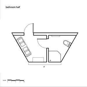

The half bath has more amenities and space. The shower is larger, and there is more storage. The bathroom is divided into two sections. The first section, which includes the entrance to the room, has a large vanity with storage and two sinks. Next to it is a shelf for additional storage. The second section contains the shower and toilet. The sinks, shower, and toilet all use purified (although still non-potable) rainwater, which, once used, will be filtered again and used to water the hydroponics.

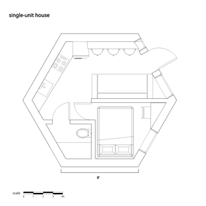

The single-unit house is the foundation of Hex-Houses, but designing a family home in just 160 square feet was challenging. Having lived in and traveled in an RV of a similar size for months, we understand where space is necessary. In such a small space, amenities must be prioritized.
When designing the floor plan, I originally began with a layout that differed significantly from the final plan. While both floorplans essentially had the same appliances and furniture in them, the final one had nearly 50 square feet of open space while the first plan had only 30 square feet. I was unsatisfied with the first plan because, in many places, the walkway was narrow and would only allow for one person to pass at a time, because the kitchen used an unnecessarily large amount of space, and there was a significant amount of wasted corner space. When reviewing the first floorplan, I realized that it was the placement of the bathroom that was the source of many of the issues and the awkward layout. Moving it to a less intrusive place would remedy many of the present issues.
It was difficult to incorporate the bed without having the bedroom take up an unreasonable amount of space due to the limited amount of places where a 6.5-foot bed could be placed. Our solution was a foldable Murphy bed. The Murphy bed converts into a closet with clothing and bedding storage during the day.
Another challenge when designing the single-unit house was storage. With most of the space being taken up by furniture and appliances, there were not many places to add storage without further restricting the space. In the end, cabinets above the desk in the bedroom, the bathroom sink, and the kitchen counter were placed. The loft has storage for personal belongings including a small closet, drawers, and two shelves. Additionally, there is storage under the couch, as well as shelving above it.
