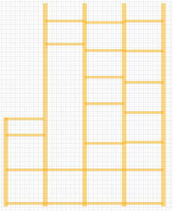

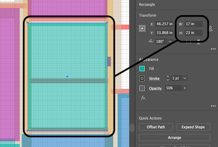

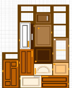

I used Adobe Illustrator to plan out the placement of the doors and shelves. This program or any other vector based drawing program will let you draw shapes that are exact measurements to the physical object.
So, first draw out the Ivar shelves as they will be built with the width of the posts (1.75"), and space between them (14"). I used the 17x20 shelves, but regardless, be sure to measure the distance between them. There is a gap between the shelves when it's constructed, so I had to guess on that distance until it was assembled.

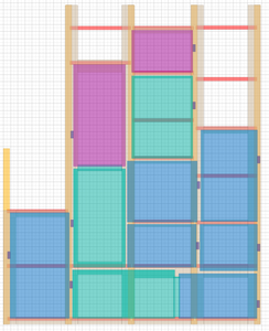

Then draw each door with it's exact measurements. I color coded mine based on whether they were new doors, old doors, or spaces I need to find a door to fit.

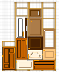

I got mine for a $1 a piece at the Habitat Restore. When I went to pick them out, I obviously looked for a range of colors and styles, but I also looked for ones that had convenient measurements. If they were within an inch of the width between posts, half, or double that space, then I bought them. I even laid them out on the floor of the store to visualize how they would fit together. I also looked for two cabinets that had one measurement in common and would add up to a convenient measurement. There's an example of this at the bottom of my cabinet plan. The two doors are similar heights, and when put together they cover three shelves.

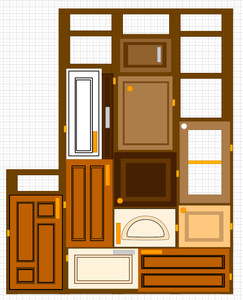

Once all your components are drawn, you can map out the whole thing precisely and ultimately get an idea of how it will look when it's done with different combinations of doors or paint treatments. I considered painting a lot of the doors some colors to go with the room, but ultimately decided against it based on what it looked like in this planning stage.

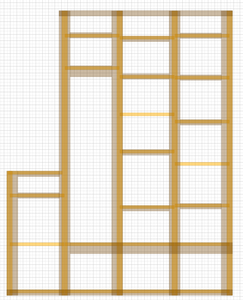

Cut your lumber to match your diagram.
Drill pocket holes into the ends and assemble the outside edge, all the vertical posts, and one horizontal piece between each of them.
I cut my horizontal pieces quite thin to keep the shelf openings as wide as possible. This made putting two pocket holes on each side difficult to fit. Therefore, I staggered the pocket hole on each side to attempt to give it more stability. this is just about the only thing I regret about this project. You need two pocket holes at every joint. Do what you have to do to make that happen.
Be sure to use a speed square or other tool to ensure everything is square.
Step 7: Frame Part 2
Now that the frame is starting to take shape, clamp it to the front of the Ivar shelf and make sure it fits.
Then, one by one, take each cabinet door, hold it up where it belongs, and tape the horizontal boards where they belong. You could use your diagram for this, but I trust my eyes more than my brain when it comes to measurements.
Once all the horizontal pieces are in place, work your way from top to bottom or vise versa. Make note of the distance from a board that is already screwed in to the first taped piece. Mark that measurement on each side. Remove the taped piece, drill pocket holes, then screw the piece in place using the measurement you made to ensure it is straight and square.
