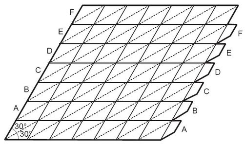

Step 3: Template for Fold Lines
In order to achieve the fold pattern of the cup around the cylindrical section, a template must first be made. I have supplied an image below that can be scaled to create a cup of any size, sourced from http://www2.eng.cam.ac.uk/~sdg/dstruct/cylinders.html. This page is also fairly compulsory reading at this stage.
Without going into too much detail of the design process, the idea was initially inspired by research done, in part, into collapsing cylindrical structures by Taketoshi Nojima (you may be interested in his paper: Modelling of Folding Patterns in Flat Membranes and Cylinders by Origami).
If you take this template and use a photocopier or printer to scale it to 22cm high (top line to bottom), then you will have a template of the exact same size as mine. Alternatively, you may wish to scale down the whole cup - it's a relatively simple operation. Whatever you do, print it out, or draw it on paper with your dark marker.

Take the printed template, and double-sided tape it firmly onto the back of your polypropylene sheet. The idea behind using a translucent colour is that you can see the template through the plastic.
You then need to take up your scapel again, and cut along the outline, MINUS the tabs (ignore these and cut staight down the fold, they aren't needed). Following this, grab the metal ruler and use the corner to score along all the mountain and valley folds. In early models, I flipped the plastic and scored mountain and valley folds on opposite sides, but I found that as long as scores were made, the plastic would fold either way easily.

Getting the plastic sheet into a cylindrical shape is where the project begins to get a little tricky. As you know, the horizontal lines, and the lines at 60 degrees, are mountain folds, so I like to begin by folding these. Just crease each line firmly in the right direction, then open it back out . After you've done these, you have to try and flatten it back out and do the valley folds in the opposite direction. This is more difficult given the surface irregularity.
When you've got the whole sheet creased, you have to start accentuating the folds so the diamonds start to close up. This is easiest if you start at one of the acute corners and work your way across the sheet. As the pictures show, you end up with a tube that has a spiral gap down it's length.
