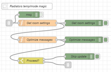

Step 5: Radiators Temperature Logic
This is where this gets dirty, be warned.
While looking simple, the complexity lies in the functions.
The first one, "Get room settings", aims at looking up desired settings from the previously defined schedule. It relies on a couple of parameters : room, scenario (or strategy), day of week, time or AM/PM.
It's main input is the "Stratégie" state :
Find below full code of "Get room settings", it is made even more complex as I wanted to automate :
- Wednesday PM : No school in the afternoon, boost living room;
- Homeworking derived from main schedule : Boost home office room temperature during office hours;
- Eco friendly limiter (again a Helper state) : Limit max temperature to 20°C regardless of scheduled temperature;
- Fully automated : Switch between office days and week end schedules;
- Special strategies for Guest / Full OFF / Full power;
- Some leftovers from Z-Wave valves : Current Zigbee radiator valves from MOES are always in "heat" mode while my previous one had "heat" and "off" states, defining 8°C in scheduler turned them off.
That's quite a list, I tried to comment the code, hope that'll be good enough. I tend to use a lot of variables to improve reading of the code.
Note to myself : Move literals to constants.
Can you spot where to inject the generated JS schedules?

Here comes the optimize "function" node.
var debugMode = false;
if (debugMode) node.warn("Optimize messages - In");
// Prevent sending a message if already at desired mode / temp
const globalHomeAssistant = global.get('homeassistant').homeAssistant;
var entityHA = globalHomeAssistant.states[msg.entity];
var currentEntityTemp = entityHA.attributes.temperature;
currentEntityTemp = currentEntityTemp ? currentEntityTemp : 0; // Prevent null
"entityHA.state : " + entityHA.state + "\n"
+ "msg.mode : " + msg.mode + "\n"
+ "entityHA.attributes.temperature : " + currentEntityTemp + "\n"
+ "msg.temp : " + msg.temp + "\n"
if (
(entityHA.state == msg.mode)
&& (msg.mode=="off" || (Math.abs(currentEntityTemp - msg.temp) < 0.5))
msg.status = "At desired mode and within temp range";
} else {
msg.status = "OK";
// All went fine, forward the message down the pipe
if (debugMode) node.warn("Optimize messages - Out");
return msg;
Step 6: Sending the Command to the Valves
Finally, let's control those valves!
Again there's a leftover from the Z-wave valves, that's why the "link in" node is skipping entirely the top part of the nodes.
For the curious, there's again a 10 seconds delay when using the "Set mode" part to prevent a slow network from mishandling mode and temperature messages.
The "call service" node uses this JSON to fetch settings sent by the previous dark magic nodes.
"entity_id": "{{entity}}",
"temperature": "{{temp}}"
