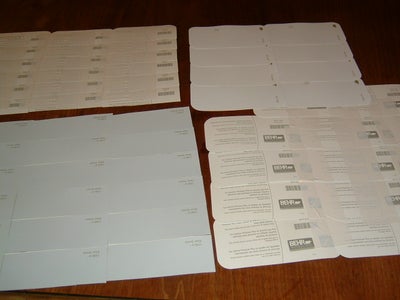

3. Pick your paint:
For the higher end, you can use screen goo - http://www.goosystems.com/index.php
http://www.theaterthings.com/
There's plenty of info about that product at those sites. I plan to use that some day (when I get more Christmas money). It sounds like a great solution.
If you want to be cheaper, like me, for now, you can select a normal paint.
--at this point I should mention that I found Home Depot more useful than Lowes for several things in this project - 1. they carry Behr brand paint and 2. they cut pieces of wood to length and sell it by the foot--

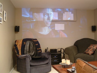

I went to Home Depot and picked several paint chips from white to light grey. Some AV forums suggested Behr 'Silver Screen" paint (770E-2). This is what I ended up using. When you have grey, it appears to be a better contrast ratio than white does. Also, I used a matte finish because it's less reflective and that's what you want.
So, I suggest picking up several different shades (make Silver Screen one of the options) and get a small stack of each individual color. When you get home, tape all of the chips of one color together so that it makes a square that is about 2-3 square feet in area.
Slap them up on the projector wall. I used painters tape as an adhesive so that it wouldn't mess up the walls. Now, watch part of a movie. Find one with good colors and sections with good blacks. Do your best not to compare the white to the greys, because you may think, "Oh, the white looks better compared to the grey." but remember that when the whole screen is one color you won't notice that. The white may have 'popped' better in my test, but I think I'm better off with the grey (because of contrast ratio). With the black border (very important & addressed later) it looks great.

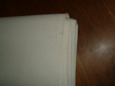

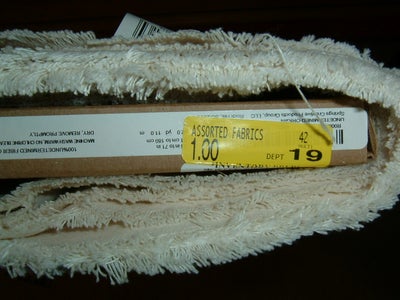

Cloth supplies: You want something like a canvas material for the screen and some black non-reflective material (thick is preferable) for the border.
I went to Walmart for the cloth. Any fabric store will do. Make sure and check the discount bin first. Also, talk to a worker. I described what I was looking for (a smooth canvas type material) and the lady found the perfect cloth for me that I would not have found. It was pretty sturdy/stiff and smooth - not like a potato sack. You may find a material that works better for you than canvas - like the back side of some pleather. The screen material only cost me a $1 per yard (I got about 3 yards worth) and the black material for the border was only $2/yard.
--Make sure to measure the area of the screen PLUS 2 inches for EACH side PLUS about 3"-4" for overlap on EACH side. Remember, you'll be wrapping this around 1"x3" slats and you want leeway on each side--

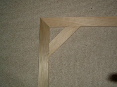

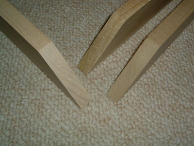

Step 3: Build That Frame!

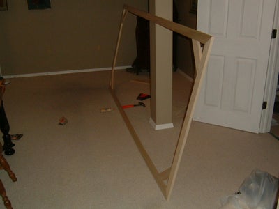

Make your cuts according the the measurements you figured out. Don't forget the corner support pieces.
--Double check your measurements before cutting. I accidentally cut one of my pieces 45" instead of 49" and had to go back and buy another piece. If you were using the same measurements as me, it would be 49" from tip to tip and 106.5" from tip to tip as in the diagram from the previous stage.
Sand any rough edges.

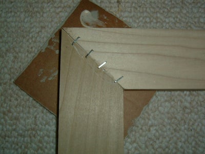

I poked little dents on the portions being glued together so that the glue had that much more surface area to touch. It may have been pointless. You may know better.
Before you start to glue, put all the pieces together to make sure you had true 45 degree angles and that it makes a rectangle correctly.
Set the 4 pieces on the ground in the rectangle. Glue the adjoining faces of two corners and stick them together. Spread any excess glue around (know that there will probably be some coming out the back).
Staple. Use a hammer to lightly tap the staples all the way in.
Repeat this with the other 3 corners.
CAREFULLY flip the whole frame over & staple the back side on every corner.
Now, glue and staple the corner supports that you cut. Hammer tap again. Staple the other side.

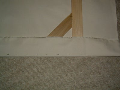

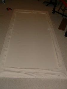

Step 4: Attach the Screen Material
After your frame has had time to dry, you're ready to add the screen material.
If need be, iron your material.
Lay the material out flat and put your frame on top.
I suggest using some help for this part. I did it by myself and it was tedious stretching it out tight/taut. If you get it pulled as taut as you can and there's still some wrinkled looking areas, do not fear. At least for me, I had some wrinkled looking areas, but after I painted, they disappeared.
With the frame centered, fold one side of the material over and staple away.
-- As a side note, I used longer staples to staple the wood, shorter ones to staple fabric and longer ones for a later step of adding the plastic trim.
Pull the opposite side as tight as possible and staple it down the same way. I started at the center of the other side and, as I pulled tightly, worked my way, stapling, towards the outer edges.
Finish off the other two sides of the rectangle.

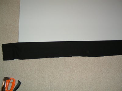

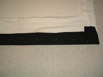

Step 6: Add the Border
Once you've painted, you are to add your border.

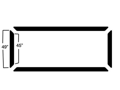

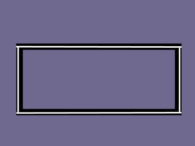

This is probably the most complicated step to explain. You may come up with a better idea. I read in some AV forum that using black paint - even matte finish ends up being too reflective.
The schematic pic is my best depiction of how I laid out the plastic 1" trim if the black material were not there. In the picture, black represents the wood frame, white represents the plastic trim pieces.
Cut the black material into strips that will cover the border area. I cut mine length-wise into 3rds and cut one of those pieces in half, which gave me four pieces the right size for what I needed. Do your own measuring. It's better to have too much that will just end up folded on the back.
I folded my black material in half to make it thicker.
This is where it kinda gets tricky in the explanation...With this, again, I'm using the measurements for my screen. If you want a bigger border, you may do it a little different. It's important to look at the progression of the pictures along with the following steps. Also, hopefully, the image notes (yellow squares) will help this make more sense.

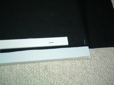

Start on one of the sides (the 45"/49" sides)
With the screen (painted area) facing up, lay your black material about an inch inside the screen with the excess laying inwards toward the middle of the screen.
Staple along the edge of the black material which will be about 2" inward.
Next, measure and mark all along the side at exactly 2" in with chalk. Also, measure 2" in from the top and bottom.

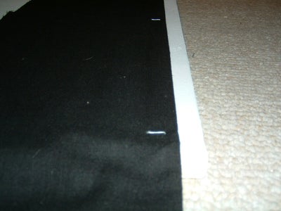

Take a piece of 1" plastic trim and cut it to 45" long.
Place the inside edge of the trim to the outside of the chalk line (so that 1. from the edge of the frame to the other side of the trim equals 2" and 2. from the inside of the trim on one side to the inside of the trim on the other side - once it's all done - equals 102.5" for the length [or 45" for the hight] of the screen). You'll also want the trim to be 2" from the top and 2" from the bottom.
Now staple this trim piece down on top of the black material (basically over top of where you stapled the black material already. I stapled one direction for the material and then perpendicular for the trim so that I didn't hit any staples when I was stapling down the trim. Through this whole process, always make sure to tap the staples down with a hammer to make sure they are flush.
You can go ahead and do this whole process to the other side as well.
Next, flip the screen over so that the back is facing up, then wrap the black material around to the back. In doing so, you are wrapping it over the 1" trim, covering it up. Make sure the material is taut.
Start this same process over for the length (Ultimately, the top and bottom of the screen). The only difference is that this time, you cut the trim to go all the way to each edge (each side). It's OK if you have to use more than one piece of trim for then length since it's all gonna get covered up by the black material anyway. The last picture in this step illustrates what this will look like once the material is stapled and you put the trim down, but have yet to wrap it around to the back.
Once you complete this for the two sides and the top & bottom, you're just about done.

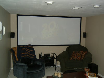

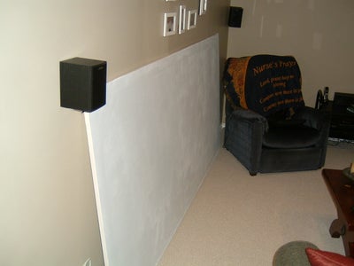

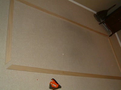

Step 7: Fasten to the Wall
I'm not putting much here because there's many ways to do this. You may want to have yours permanently affixed to the wall.

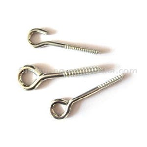

I put the finished screen up to the wall centered exactly, then measured from the edge of each wall to the middle of the 1"x3" on each side (this should be the same on each side if you want it centered). then I screwed in these hardware pieces - a screw with an O-ring - to the back of the frame making sure that the screw portion was short enough that it wouldn't protrude out the front of the black border area (that would be ugly).
On the ceiling, I used screws with open-ended hooks. I made the holes and used drywall anchors to give it enough strength to hold up the screen (trust me, if you're not screwing into studs, you need drywall anchors). Remember, if you're hanging it close to the ceiling, you need enough wiggle room to get it hooked and unhooked.
Like I say, you may find a solution you like better for hanging yours. This way works for me and I can easily mount or dismount it from the wall when not in use.

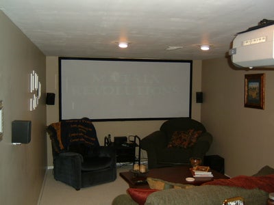

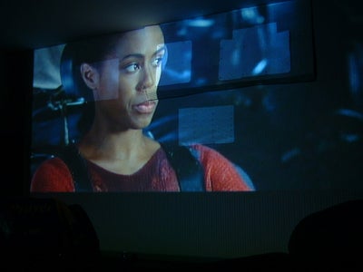

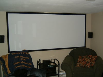

Step 8: Enjoy Your New Screen
Here are some pics of my finished product.
**A note about aspect ratio: To get the measurements for my screen, I chose a movie with the 2.35:1 aspect ratio (movies like Matrix, Starwars, etc.) and blew the picture up to the size I wanted. When I watch content with 16x9 or 4x3, there is white showing on both sides of the screen not being used. To address this, I added black curtains (along with a black skirt) so that it covers up any unused portion of the screen (See pics below). The result is that the entire wall is either the movie or black. Another way to address the aspect ratio variation would be to create a 4x3 screen that was much taller, but still as wide as possible. Then, you could have a black skirt that you raise up for 16x9 content or 2.35:1 content. This way, regardless of the aspect ratio, your content will be as wide as possible on your wall.
Make sure to have a party for the inaugural movie viewing.
