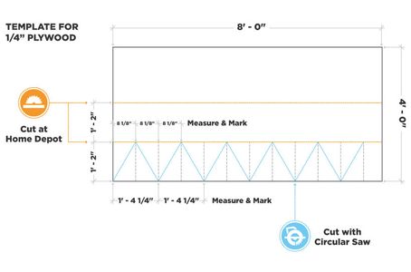

Step 2: Pick a Size
The triangles should be about the same height of your sitting dog. Fletcher is about 14” tall sitting so I had the nice people at Home Depot cut two 14” wide strips of plywood for me.
Step 3: Measure, Mark and Clamp the Two Boards Together
The doghouse is made from equilateral triangles. Measure off the triangles and then clamp the 2 boards together.
Step 4: Cut the Plywood
Once the triangles have been marked, use the laser guide on your RYOBI circular saw to follow the lines and cut the triangles.

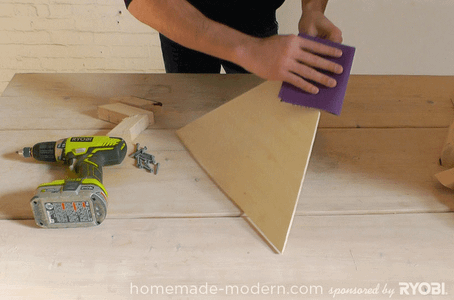

Step 6: Sand the Edges
Use 200 grit sandpaper to smooth down the edges.
