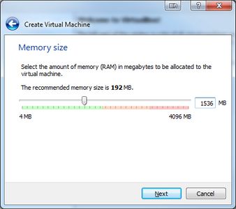

Step 3: Allocate Memory
This depends on how much memory you have on your host computer. Never allocate more than half of your available RAM.
If you are creating a Windows VM I recommend at least (1-2 GB)
If you are creating a Linux VM I recommend at least (512 MB)
NOTE: Stay within the green target amount.

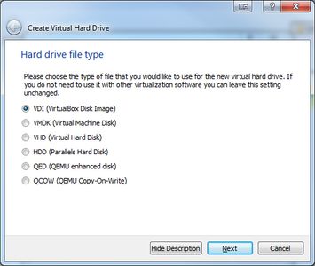

Step 5: Select Hard Drive File Type
Select 'VDI.' This is usually the best option.
The VM will be stored in a single file on your computer with the .vdi extension.

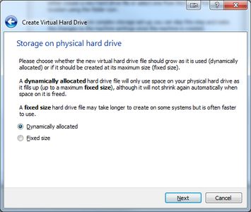

Step 6: Select Storage on Physical Hard Drive
I recommend you choose "Dynamically allocated." This will save space on your computer.
NOTE: "Fixed size" may have a slightly better performance, but will take up more space on your computer.

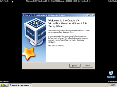

Step 9: Install Guest Additions
Guest additions add more functionality to your VM, including the option to make the VM fullscreen.
NOTE: You must install guest additions in safe mode (Windows) to enable 2D and 3D acceleration.
Boot in Safe Mode.
Instructions for Windows XP
When you have booted in Safe Mode, click Devices --> Install Guest Additions
Follow the Prompts and Install.
Shutdown the VM.
Boot in Safe Mode.
Shutdown the VM.
