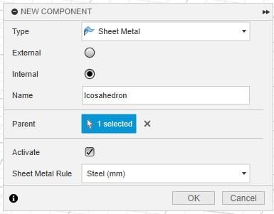

First, create the component we will work on by clicking on the New Component shortcut (Shown in the image above, underlined in green). Now that we have our new solid component we can start a new sketch via the shortcut in the toolbar (underlined in red). Start by selecting the x-axis plane. Draw a pentagon via Create > Polygon Tool. We want to centre this on the origin of the model. Using the dimension tool (Hit 'd' on your keyboard), select one side of the pentagon and set it to the user parameter "sideLength" (As this pentagon is really the base of 5 triangles as you'll soon see). Next, we want to enable the 3D Sketch option as shown below;
It's normally best to avoid 3D sketches where possible, but in this case, they serve our function well. Start by drawing 5 lines (Hit 'L' on your keyboard) starting from a point of the pentagon, and meeting at a point above the pentagon. Since an icosahedron is made up of equilateral triangles we want to use the equal constraint on one of the lines and the side of the pentagon that we have set to "sideLength" as shown below;
