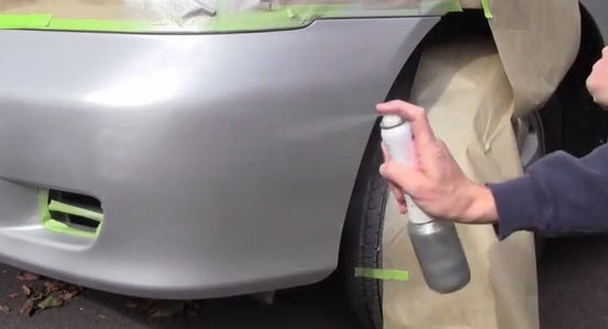

Step 1: Apply Masking Tape
Mask off areas around the damaged area that you do not want to be hit by spray paint.
Step 2: Sand Bumper
Using firm pressure, sand the damaged area of the bumper until you have smoothed the scratches out.
Step 3: Clean Panel
Wipe down the panel with a cleaning towel, then clean the entire area with wax and grease remover.
Step 4: Fill Scratches
If you find any scratches that will not sand out, fill them with a thin layer of scratch-filling putty.
Give the putty five minutes for it to harden, then sand it using some coarse sandpaper.
You might need to repeat this step again in order to smooth everything out.
Step 5: Scuff Repair Area
Using a grey scuff pad, scuff about 10 inches around the repair area.
This will help the paint stick and be more durable over time.
Step 6: Prime Bumper
Apply a thin layer of primer, wait two minutes, then apply a heavier layer of primer until you have covered any areas exposed by sanding.
Step 7: Paint Bumper
Sand the primer using fine-grit sandpaper with light pressure until it feels smooth.
Apply multiple coats of paint from a distance of about 10-12 inches.
If you encounter any bumps, cloudiness, or what looks like "cat" scratches wait five minutes, sand again, and re-apply paint.
If you car is silver or gold and you notice stripes, following up with some vertical passes.
Step 8: Clearcoat Layer
Give the paint five minutes to dry, then apply a light layer of clearcoat.
Wait two minutes and slowly apply a heavier layer, overlapping each pass by around 50%.
Give the clearcoat 10 minutes to dry before removing the tape and paper.
