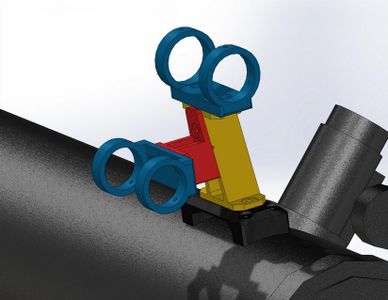

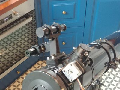

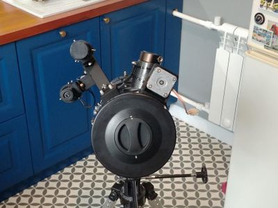

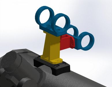

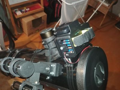

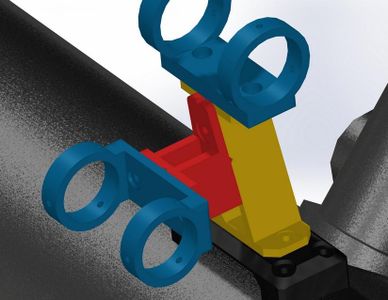

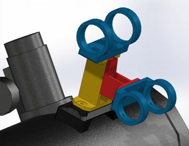

Step 4: Finderscope
/// EN ///

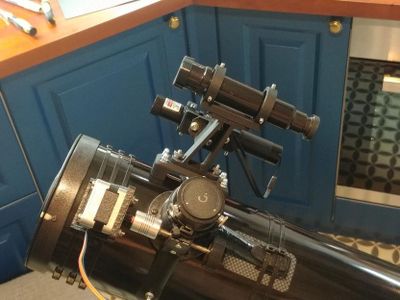

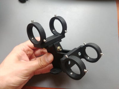

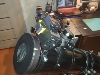

Ok, now let's do some serious stuff... This is also very important step.
The finderscope that came with telescope is also terrible, and if you have that option, consider purchasing the good new one.
However, there's also a way to improve the one you already have. Unfortunately there's not much you can do with the finderscope tube, but you can make a good and firm holder for it. And also install the laser pointer which may be super udeful.

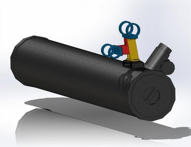

WARNING! In this step you will need a 3D printer or at least a 3D printing service in your city.

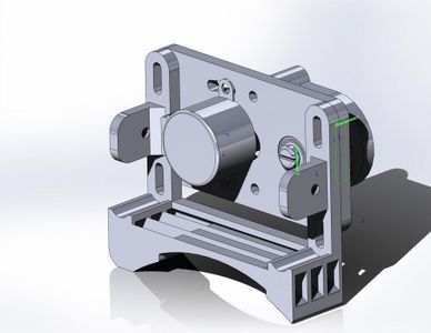

The idea was pretty simple - to make a totally new holder that would be able to still keep collimation with the telescope even after several remove/install procedures (my scope is not staying on the backyard, so I have to take it to the place every time, then assemble, then disassemble and put back to the shelf). And as an addtition I also made a small platform for a green laser pointer.
Here's a link to Thingiverse, where you can download all .STL files for printing:
https://www.thingiverse.com/thing:5022596
To assemble the whole thing you will need some M4 screws and nuts!
IMPORTANT! If you are using a cheap green laser pointer during the cold weather conditions, the lightwave can slide from green spectral zone to infrared. So if you see that green light is too weak and think that battery is dying, never look directly into the beam, this may harm your eyesight.

Ну а теперь займемся серьезным делом... Это тоже очень важный и обязательный к исполнению шаг.
Искатель, поставляемый с телескопом, просто ужасен, поэтому если у вас есть возможность, рекомендую купить нормальный (благо на Али их хватает).
Однако есть способ улучшить и родной. К сожалению, с трубкой искателя мало что можно сделать, зато можно собрать надежный и прочный держатель взамен гнущегося от любого чиха оригинального.
ВНИМАНИЕ! На этом этапе вам понадобится 3D-принтер или хотя бы сервис 3D-печати.
Идея довольно простая - сделать совершенно новый держатель, который мог бы не сбивать настроек искателя даже после нескольких снятий/установок. А еще в качестве бонуса сделал небольшую площадку и держатель для лазерного целеуказателя.
Вот ссыль на Thingiverse, где лежат все .STL модели для печати:
Чтобы собрать всю конструкцию, Вам понадобится немного болтов и гаек размера M4.
ВАЖНО! Если Вы используете дешевую зеленую лазерную указку при низких температурах, может проявиться эффект дрейфа длины волны с зеленой части спектра к инфракрасной. Поэтому, если Вы видите, что зеленый луч слишком слаб, никогда не смотрите прямо на него, это может повредить зрение, поскольку в инфракрасной части спектра мощность луча по-прежнему высока.

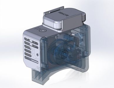

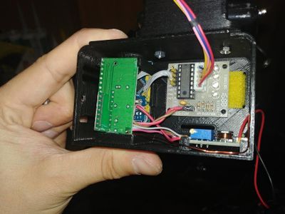

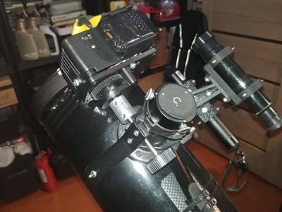

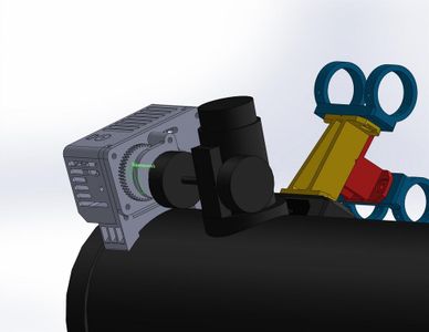

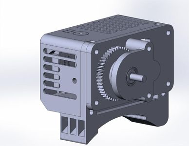

Step 6: Electronic Focuser With Remote Controller
/// EN ///

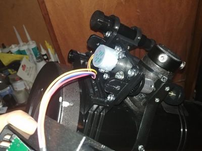

Now we are coming to a third crucial step.
The main problem of this telescope is very weak mount. The image in the eyepiece begins to wobble at the slightest touch to the telescope. You can, of course, replace the mount and tripod, but this will be very expensive. Therefore, you can try to minimize the number of touches of the telescope. But how do you do this if you need to adjust the focus after finding an object in the sky? That's right, you need to make a device for remote control of the focus wheel. This step will help you to make one!
IMPORTANT! This step requires using a 3D printer or 3D printing service. It also will be necessary to solder some wires and upload a code to Arduino board.
What we'll need:
- Arduino Nano board
- 315 MHz radio module + remote controller
- 28BYJ-48 stepper motor + driver
- power booster module
- piezo buzzer (not necessary)
- 9V battery connector
- velcro for the battery
- flexible shaft coupler 5 x 5 mm
- bearing 5 x 14 x 5 mm - x2
- shaft - M5 x 35mm
- screws M4 x 20 mm - x2
- screws M4 x 10 mm - x4
- screws M4 x 10 mm + nuts - x2
- screws M4 x 8 mm - x2
- set screws M4 x 10 mm - x3
- screws M3 x 6 mm + nuts - x2
- all the printed stuff from Thingiverse - https://www.thingiverse.com/thing:5022610
IMPORTANT! Before the assembly of the device you need to set the power booster output voltage to 10V.
The assembly is pretty easy and can be seen on pictures.
After the assembly is finished, you need to upload the code to Arduino board. To do that you need to install the Arduino IDE first, then open the Focuser_28BYJ-48.ino file attached in the end of this step (after the ///RU/// part) and then upload it to the Arduino board.
Here's YouTube manual how you can do that. It's a beginner's guide, so if you never heard of Arduino, I recommend you to wath the video from the beginning to the end.
After the code is uploaded, you can plug in the 9V battery or powerbank and try the device. If everything is wired correctly, it will work.
WARNING! Never exceed the 9V input power limit!
WARNING! Never plug in 9V battery and powerbank to the device at the same time!
IMPORTANT! If you are going to use the device during cold weather conditions, there may be a necessity to use more powerful batteries, which will require to rebuild the power system a bit.

After the assembly is finished, you need to upload the code to Arduino board. To do that you need to install the Arduino IDE first, then open the TS_Tracker_Drive.ino file attached in the end of this step (after the ///RU/// part) and then upload it to the Arduino board.
For this device you will also need to install two libraries for Arduino IDE (Accelstepper and GyverEncoder). They both can be found in Arduino labrary manager. Here's how to do it: https://www.youtube.com/watch?v=c9EjWEVK118
The device needs 18V of power which can be taken from two 9V batteries connected in series. To power it up you need physically connect batteries to the connectors (there's no power switch). This scheme actually turned out to be good only for testing in the field, so I'll make a new power system in future.
You can also make your own power system even without converters and 9V batteries. It's up to you if you know what you're doing!
On the face of the controller box there are two switches and encoder. One switch turns on and off the motor driver (but not the device itself!), second switch selects the rotation direction (for North and South hemisphere). Encoder controls the speed of the motor: rotation left/right decreases/increases the motor speed by 1, rotation left/right with the knob pressed decreases/increases the motor speed by 10, one short click resets the speed to original value of 11 steps/second.
WARNING! Never disconnect the motor from the controller when power source is connected. It will damage the motor driver.

А вот и четвертый важный шаг. Применим только к экваториальным монтировкам.
Второй способ устранения тряски - установка привода на часовую ось, чтобы отпала необходимость крутить ручку самому.
Можно купить готовым вот такой вот привод (Celestron Precision DC Motor Drive). Он относительно дешев и очень прост в установке и использовании. Но у него есть один главный недостаток - по мере расходования заряда батареи, будет падать и скорость мотора, поэтому периодически придется подкручивать крутилку скорости. В остальном устройство хорошее.
Однако, если у Вас есть жгучее желание сделать нечто подобное самостоятельно, то читаем далее...
Устройство очень простое, но все равно придется немного попечатать, попаять и загрузить код.
Как устройство работает: мотор вращает часовую ось телескопа через редуктор, мотор управляется платой Arduino через драйвер.
Конструкцию держателя шестерен и мотора я взял отсюда: https://www.thingiverse.com/thing:1923236
Если вы собираетесь использовать шаговый двигатель NEMA17 (или любой другой с 200 шагов на оборот), вам также следует распечатать две шестерни по ссылке выше. А вот коробку для мозгов устройства вы можете взять по моей ссылке ниже.
Я использовал брата-близнеца NEMA17, которого зовут 17PS-M058-G3W. Этот двигатель выдает 100 шагов на оборот, поэтому пришлось переделать шестерни. Соответственно, если вы используете тот же двигатель, вам понадобятся шестерни из моего набора.
Я также разработал корпус для электроники и сделал код для Arduino.
Вот ссылка на мой дизайн: https://www.thingiverse.com/thing:5022624
Нам понадобится:
- Arduino Nano
- NEMA 17 шаговый двигатель или его близнец (17PS-M058-G3W)
- A4988 драйвер
- XL4015E понижающий преобразователь
- 360-Mini понижающий преобразователь
- Энкодер
- Колпачок для энкодера
- SS-12F44 переключатель - x2
- Конденсатор 470uF/16V
- 9V коннектор - x2
- Липучка для крепления корпуса
- подшипник 6x19x6 mm - x1
- болты M3 x 12mm - x10
- шайбы M3 - x4
- гайки M3 - x6
ВАЖНО! Перед сборкой необходимо выставить выходное напряжение преобразователя XL4025E на 10 вольт, а выходное напряжение преобразователя 360-Mini на 6 вольт.
Сама сборка еще проще, чем сборка фокусера из предыдущего шага, все видно по фотографиям.
После завершения сборки Вам необходимо загрузить код в плату Arduino. Для этого вам необходимо сначала установить IDE Arduino, затем открыть файл TS_Tracker_Drive.ino, прикрепленный в конце этого шага, а затем загрузить его.
Вот ссыль на руководство, как это сделать. Оно для новичков, поэтому, если Вы никогда не слышали об Arduino, я рекомендую Вам просмотреть видео от начала до конца.
Для этого устройства Вам также потребуется установить две библиотеки для Arduino IDE (Accelstepper и GyverEncoder). Их легко можно найти в диспетчере библиотек. Вот как это сделать: https://www.youtube.com/watch?v=c9EjWEVK118
Устройству для питания требуется 18 вольт, которые можно добыть от двух последовательно подключенных 9-вольтовых Крон. Для включения устройства необходимо физически подключить батарейки к разъемам (выключателя питания нет). Эта схема питания оказалась не самой лучшей, так что постараюсь в ближайшее время переделать.
Вы также можете сделать свою систему питания даже без преобразователей и батареек, а, например, на аккумуляторах. Если знаете, что делаете, то вперед!
На лицевой стороне корпуса устройства есть два переключателя и крутилка. Один переключатель включает и выключает драйвер мотора (но не само устройство!), Вторым переключателем можно выбрать направление вращения (для северного и южного полушария). Крутилка регулирует скорость двигателя: вращение влево/вправо соответственно уменьшает/увеличивает скорость двигателя на 1, вращение влево/вправо при нажатой крутилке уменьшает/увеличивает скорость двигателя на 10, одно короткое нажатие сбрасывает скорость до исходного значения в 11 шагов в секунду.
ВНИМАНИЕ! Никогда не отсоединяйте двигатель от контроллера при подключенном источнике питания. Это повредит драйвер.
ВАЖНО! Если Вы планируете использовать устройство при низких температурах, возможно потребуется применение более мощных аккумуляторов, что, в свою очередь, приведет к необходимости слегка изменить схему питания.

- Mount
- Finderscope
- Elecrtic focuser
- Polar axis drive
- Focusing masks

- Монтировка. Однозначно полная переборка дала положительные результат, но сразу говорю, не стоит от нее ждать каких-то выдающихся показателей. EQ1 - слабая монтировка, даже в идеальном состоянии она будет выдавать шевеленку при малейшем дуновении ветра.
- Искатель. С новым крепким искателем стало в разы удобнее работать. Быстрая наводка в сектор с помощью лазера, и далее тонкая настройка оптическим искателем значительно сокращают время наведения. Плюс, за все время тестирования многократный процесс установки/снятия искателя не сбил юстировку.
- Электрофокусер. Результат просто космос! Я даже не ожидал, что будет настолько удобно с ним работать, и что он будет выдавать такой результат. Однозначно стоит собрать и установить. Единственное, соединение вала шестерни и вала привода фокусера лучше производить жесткой втулкой, а не виброгасящей - тогда будет отсутствовать эффект "выбирания слабины" при изменении направления вращения.
- Привод часовой оси. Тоже шикарная штука. Съемка роликов для последующего скармливания софту теперь одно удовольствие. Крутилкой подбора скорости можно добиться стабильного положения объекта в кадре в течение длительного времени. Единственное, надо будет перемоделировать кронштейн крепления мотора, тот что используется сейчас - слабоват, люфтит.
- Фокусировочные маски. Исключительно незаменимые вещи для идеального фокуса. Смоделировал и напечатал парочку оптимизированных разных типов. Обе лежат на Thingiverse.
