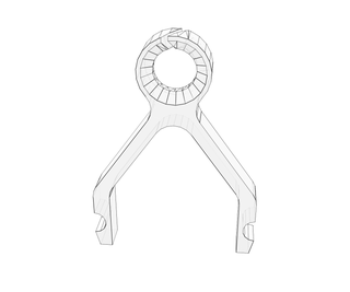

• The first addition I will be paying attention to is the filament spool holder. If your filament spool is just laying next to your printer, the filament can not unroll, so it will twist and form spirals, as can be seen on the first picture. When printing proceeds, the amount of twist will increase and with it the internal stress in the filament. These spirals could get in the way of your printer's axes and block them during printing, which means you will have to print the object all over again. Also the internal stress could increase until the filament breaks, which might result in your printer having no filament while being halfway a print. Enough reason to print a filament spool holder.
There are a lot of different filament spool holders on Thingiverse, so pick one which suits you and goes well with your printer. You could choose a spool holder which supports the spool using four ball bearings. Most of these spool holders are universal. You can use them with any 3D printer, because they stand next to the 3D printer. You could also choose something more specific which is connected to your 3D printer, like a spool holders which is basically a printed rod extending to the side (or sometimes upwards on the topside, but this is only common on delta 3D printers) of the printer, designed to hang the filament spool on. These spool holders are printer-specific, because every 3D printer has another ideal spot to connect such a spool holder. I am currently using this type of spool holder on my Prusa Mendel I2 and I attached the stl file to this step. I personally think this spool holder is better than the last one, because it takes up less space on your table or desk. On Thingiverse you might find some filament spool holders which are placed on top of the 3D printer. With these spool holders it is relatively easy to guide the filament to the extruder, because the spool will always be above the extruder. The big disadvantage of this type of spool holders is that a full filament spool is pretty heavy. Placing this on top of your printer, rises the center of mass of the printer, which will cause it to vibrate more and more intensive. This is why I do not recommend this type of spool holder, unless you are using a delta 3D printer.
When you are using a spool holder which is to the side of your 3D printer, I recommend using a filament guide. Filament guides can also be found on Thingiverse. Choose one you like and goes well with your 3D printer. I included one which is compatible with the Prusa Mendel I2. To make sure my spool holder does not break off or rotate around my frame, I designed a little stand for the outer end, so it is supported at both ends. The end which is connected to frame can be mounded with two rod claps, which are also included.
When choosing a filament spool holder, keep in mind that the filament spool needs to be able to rotate freely. If it can not, your extruder needs to pull to hard and will start slipping. The coefficient of friction between normal PLA spool holders and the spool's plastic is low enough to not cause any problems.

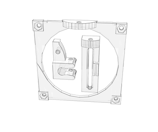

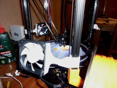

• The second addition I will be paying attention to is the fan holder. I will be discussing the use of the fan itself in step 3. Basically there are 2 locations to connect the cooling fan to: the frame and the extruder. When you have a small fan, connecting it to your extruder is a wise thing to do, because it will not be able to move a lot of air per unit of time. This means you will want to place it as close to your print as possible. When you have a big fan, I recommend you connect it to the frame. Connecting a big fan to your extruder will limit it's movement drastically, because it probably will collide with the printer's frame, printing bed or the print. A bigger fan will be able to move more air per unit of time. This causes it to still be effective when being on a distance from the print. To clear out what size is big and what is small: 60x60 mm and up is big, 40x40 mm and down is small. Since every extruder and frame is different, you will have to look for a suitable fan holder for your printer on Thingiverse, or design one yourself. I included the one I am using on my Prusa Mendel I2. I am using one for a big fan (80x80 mm) connected to the frame. I downloaded this design from Thingiverse, but could not find the original source any more.

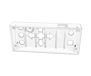

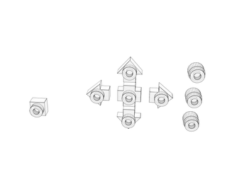

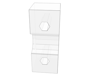

• The last printable additions I will be paying attention to are two additions which are specifically useful for Prusa Mendel I2 users. I moved my Z stepper motors to the bottom of my printer, instead of leaving them at the top of the machine. I did this to lower the center of mass of my printer and to not have all the weight of the extruder and x axis hanging on my z couplers. This resulted in my Z motors hanging just a couple millimetres above the table's surface. That is why I downloaded this dust cap and made the bottom a bit thicker, so my motors were supported by the table's surface. This file with extra thick bottom is also added to this step.

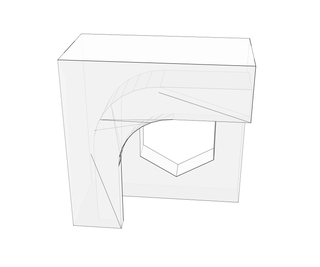

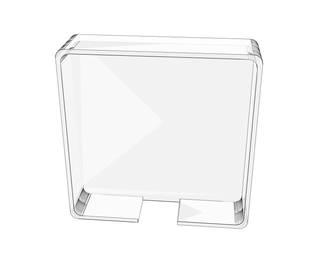

The very last printable addition I would like to discuss is the bed levelling nut holder. I designed this model myself, because I found myself having to level the bed after every print I made. This was because every time I printed something, the nuts underneath my print bed would loosen due to the movement of the bed. I tried to put two nuts really tight to each other, but that did not work. Then I designed these things, printed four of them, put one on each corner of my print bed to keep the M3 nuts from rotating and I never had to level my bed again. This part is also included.

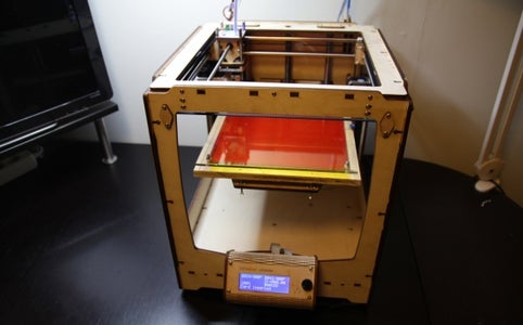

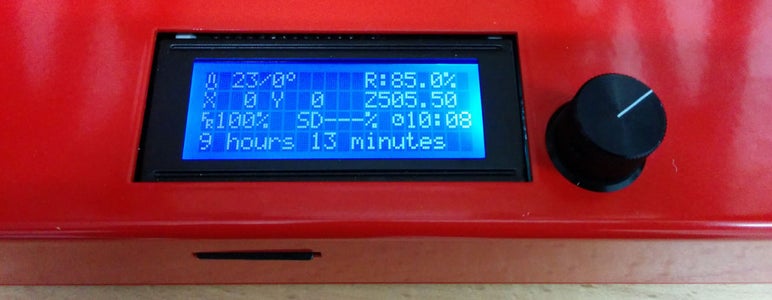

Autonomous Printing is when your 3D printer can print on it's own. This means it does not need a computer connected to it while printing. This is absolutely advisable! If your 3D printer does not have this, there must be a computer turned on near your 3D printer at all times during printing. If this computer goes standby, the printing will stop immediately, whether it is finished printing or not. To prevent this from happening, you could adjust your computer's settings, so it will never go stand by, but you would still need a computer near to your 3D printer. It is much better to not have need of a computer near your 3D printer and to be able to control your 3D printer's axes and heaters without the need for a computer.
You can easily see whether a bought 3D printer is able to print on it's own by checking if it can read an SD card. If so, the 3D printer is most likely autonomous. It is possible the 3D printer is able to print from an SD card, but can not start printing without being told to do so by a computer, but this is uncommon with bought 3D printers. To make sure you won't need a computer for that either, you could check if the 3D printer has a display. The most common display on 3D printers is a 20x4 LCD. These displays often come with a rotary encoder to navigate through the menus. Some (more expensive) 3D printers have a full graphic LCD or even a touchscreen display. Of course you can also use this with your home made 3D printer, but a touchscreen is everything but cheap.
With home home made 3D printers you can choose yourself if you want to invest in an LCD, control panel and SD card reader, but I absolutely recommend it. I bought my LCD at reprapworld, just like my keypad. The keypad has a rotary encoder to navigate though the menus, an enter button to select elements in the menu and 8 other buttons. I changed my 3D printer's firmware so that these 8 buttons now control my printer's axes. If you would want to know how I did this, let me know. If I get a lot of requests, I will post how to do this. Furthermore I have connected a buzzer to my 3D printer. Almost every bought, autonomous 3D printer have a buzzer build-in. I strongly recommend to connect a buzzer to your home made 3D printer, not because it will give a small beep every time you press enter, but because it enables you to use the M300 Sf Pm m-code to make the buzzer beep at frequency f for m milliseconds. This is useful because you can use a couple of different frequencies in a row to play a melody. By adding a few extra lines at the end of every gcode, your 3D printer will play that melody every time it's done printing. In chapter Software: Gcode Generators I will explain how to do this.

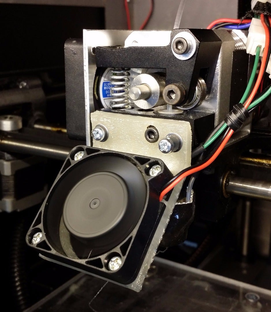

Step 3: Hardware : Cooling Fan
A cooling fan is a thing you will absolutely need, unless you are planning on only printing pyramids. A cooling fan will cool the filament coming out of your 3D printer's nozzle, which allows it to solidify faster, which in turn allows you to print longer bridges and more extreme overhang. Every bought 3D printer I know has a cooling fan build in, so nothing to worry about. It is a whole different story with home made 3D printers. Kits sometimes come with a small fan, but in order to connect this fan to the extruder, you will need a printed part which is rarely delivered with the kit. Luckily you could build the printer without fan at first, then print a fan holder and then connect the fan to your printer.
Like I already explained in chapter Hardware: Printable additions, a cooling fan can be connected to the extruder or to the frame of the 3D printer. If you have a big cooling fan (60x60 mm and up), it is better to connect it to the frame, not the extruder. When connected to the extruder, it might collide with the printers frame, print bed or the object it is printing. A small fan (40x40 mm and down) can be connected to the extruder. A small fan will not be able to move a lot of air per unit of time. This is why you will want to have a small fan as close to your print as possible and so you need to connect it to the extruder. On the other side, a big fan is able to move a lot of air per unit of time and so it will still be useful if it is placed further from the print. Therefore it is wise to connect a big fan to the frame in stead of the extruder. This also allows a big fan to cool the entire print at once, while a small fan will only cool the filament coming out of the hot end.
