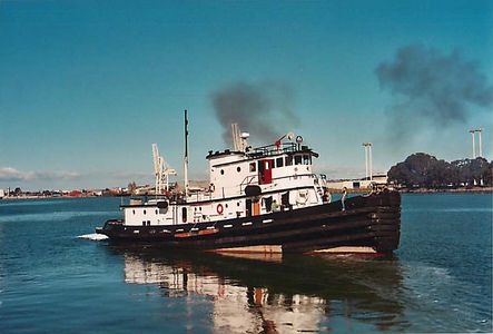

How I converted a tired US Army tugboat into a yacht/tug. This project took 10 years to be 90% complete. Hardest part is finding a berth for something this big, at a reasonable price.

Start by hunting around the waterfront. Hang out in dive bars. Comb Craigslist in the Seattle and SF Bay area sections. British Columbia has lots of great old tugs. Join the Retired Tugboat group on FB. Our search took us from San Diego to Vancouver. One of the first boats we considered seriously was an Army LT type tug (the LT-2080) Located at Rough and Ready island in Stockton Ca. that had been modified for use in atmospheric diffusion testing (read that chemical weapons testing) in a top secret project called SHAD. the problem with this boat was it glowed in the dark. So my wife and I wrote that one off our list.
We finally found our dreamboat in an add in Boats and Harbors, a newspaper style magazine dedicated to selling used marine equipment. Everyone loves an auction right? We had 7 others bidding against us including my best friend.
