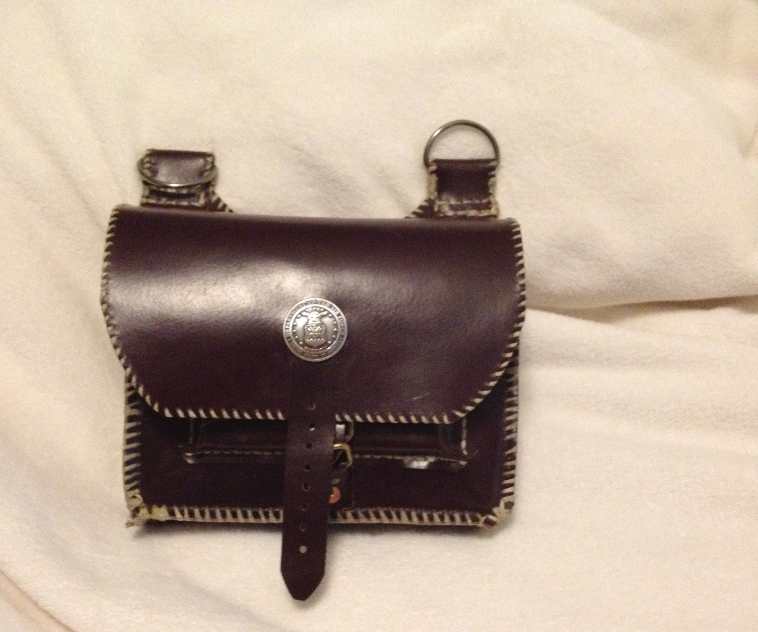

Ok, So I made a hunters pouch/Possibles bag and I had this powder horn that was pretty nice but too long, and I was not happy with the end cap or powder drop. I also had a couple of real weathered steer horns and they are in the picture as a size comparison. what I want is a horn no more than about 9 inches long.
