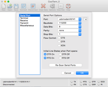

You will need the free software CoolTerm to read data sent by the Arduino with the AppleScript.

2- Install CoolTerm
3- Open CoolTerm, click Options, click Re-Scan Serial Ports, set everything as in the image.
The port can be different, it will be something like usbmodem, which is the Arduino.
When you finish the configuration click OK and then click Connect.

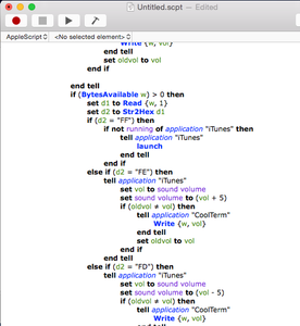

4- Open the AppleScript in the Script Editor. To run it click the Play button.
5- Now you can use the controller.
